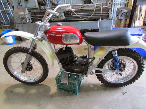

    I thought I would post up some pics as I go thru this barnfind 250WR to put it back into a competitive form once again. Here's how she looked when I brought her home, vines and all......haha
    I'm currently in the teardown phase. This bike belonged to an old friend of mine who used to race with us in the mid seventies. He bought this bike new and has kept it for some 40+ years. It last ran 20 years ago and was parked with 1/2 tank of gas still in it...........Here we go!

    Back to work on the '73. This is how the wheels looked prior to cleanup/polish and hub repaint..........lots of years of neglect.
    The new seals, decals and air filter came in from Vintage Husky. Also received a new seat cover for the project. Forks have now been rebuilt, painted and remounted and the new seat cover installed. Got her to the "roller" phase now.

    I had a seal leaking on the shifter so I removed the clutch cover after draining the tranny oil. Surprisingly the old oil looked very good. No sign of moisture after 20 years of sitting and hardly any residue in the oil. Removing the clutch cover revealed a very clean clutch and other internals.
    Knocked out the old shifter seal and replaced it with a new one. Removed the head to find a nice clean bore and everything in spec for a standard bore! Great news there. Buttoned everything back up and finished up the prep for engine paint and applied 3 coats of Duplicolor Semi Gloss Black engine paint.
    I completely sanded and prepped the gas tank for paint. Then using 3 coats of etching primer and 4 coats of Duplicolor Cherry Red the tank turned out pretty darn nice. In the pic I still haven't polished the chrome panels or done the white pin stripes around the chrome. Anyway, this is how the paint looked.............
    Waiting on carb parts from Bing to come in. Almost ready to fire the old girl up..............

    Ok, I'm still waiting on a couple of parts from Bing to come in but I couldn't resist a few shots of the finished results. I gotta admit I'm pretty proud of her as I have never tried this level of rebuild before.
    You've got to remember, this is where I started........

    Finally got the carb parts in from Bing today. Two hours later and after only 3 kicks she roared to life after twenty years of sitting silent. It ran perfectly, good power and shifts thru all the gears easily. The only thing I didn't realize is the old drum brakes don't stop nearly as well as the discs on the 449. haha
