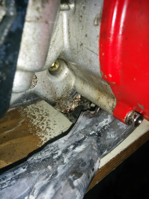

    oh dear... check out those motor mounts! someone fancied themselves a welder. they were not. (luckily, i am :) )
    in short:
    every motor mount is jacked up.
    every bolt taken off so far is a grade 5 SAE hardware store bolt.
    i have only marginal faith in the motor so i'll at least pull the top end and check for crank play.

    that roached together motor mount is at least there... more than i can say for some of the others...
    can't say i haven't seen worse (i build/ride old harleys, triumphs, etc)... but damn.
    the only way i can think of breaking every single motor mount is vibration cracking from leaving fasteners loose. i don't know the story behind the bike, but i'm guessing it involves abuse, neglect and beer. then someone decided to "fix" it.

    the first time the fasteners were replaced with other than correct replacement the cascade began
    you are seeing the end result of beer engineered, i drink beer from time to time, they abused it from time to time

    i'm not opposed to grade 5 fasteners... the proof load & yield strength should be damn close to the metric 8.8 that i'm guessing was originally used... but the diameters. SAE <> Metric.
    new metric fasteners are on the list. so is a right side panel (missing). i know DC isn't OEM quality by a long shot, but at least they've got plastics...

    seriously dont know how they jacked up the motor mounts so badly... i'm cutting them off and fabbing up new ones
    if you look closely, you can see the case damage from some attempt at welding the motor mounts... seriously, it took me under 20 minutes to have the motor out of the frame; they couldn't do that?
