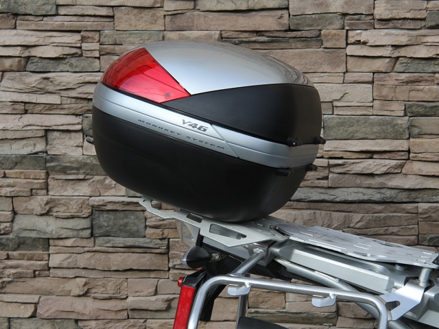

    I really like the looks of the Nomadic rack. I already have the Husky/Givi side racks and cases. I want to use one of the side cases as a top case when I don't need so much space commuting during the week. I'm spoiled by the simple looks of the Givi mounting kit that AltRider sells. I have the same setup on my FJR with a PCA rack.
    I contacted Nomadic and was told I'd need to use the plastic E250 plate to mount a Givi top case to their rack. It isn't a deal breaker and I already have the E250 plate. I wish Nomadic was interested in redesigning their rack to accommodate the Givi kit, but I can't blame them for not wanting to invest more in the TR650.
    I'm tempted to get the Nomadic rack and drill my own holes for the Givi mount if there is room. Or just live with the E250 plate and quit whining about my first world problems!
    Givi Mounting Kit
    Here's the kit installed on AltRider's Multistrada rack.
