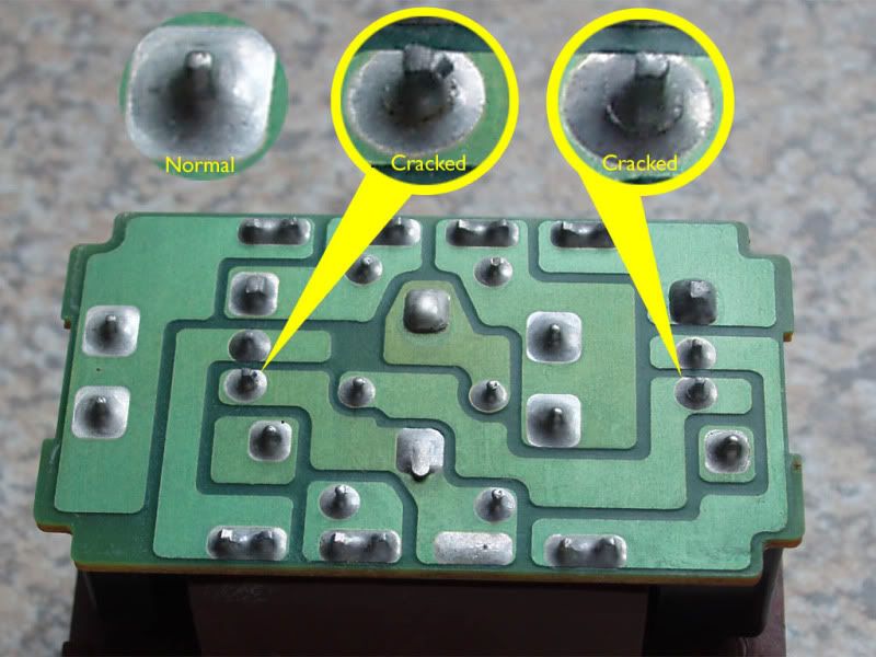

  7. gots_a_sol Husqvarna
    Charles Town, WV
    WR177
    17 250RR
    Probably has bad solder joints and heat/humidity cause them to expand and lose connection.
    90's Honda cars were notorious for bad solder joints in the main relays and wouldn't start when hot/humid out.
    robertaccio and Powellyte450 like this.

  13. gots_a_sol Husqvarna
    Charles Town, WV
    WR177
    17 250RR
    Powellyte450 likes this.

    Thanks a lot Man yeah its like a rubber I found a guy on youtube who soaked a CDI unit in Acetone to remove it which it did but also that messed up the wire shielding too so Ill keep looking but its going to be around 400 bucks for Carmo to do it so its worth the gamble.
