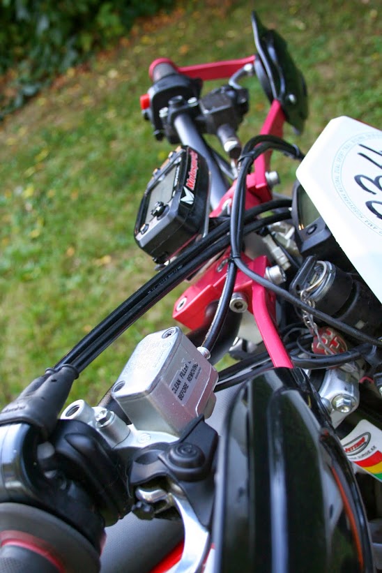

  4. Motosportz CH Sponsor
    I run the HDB's on mine and love them.
