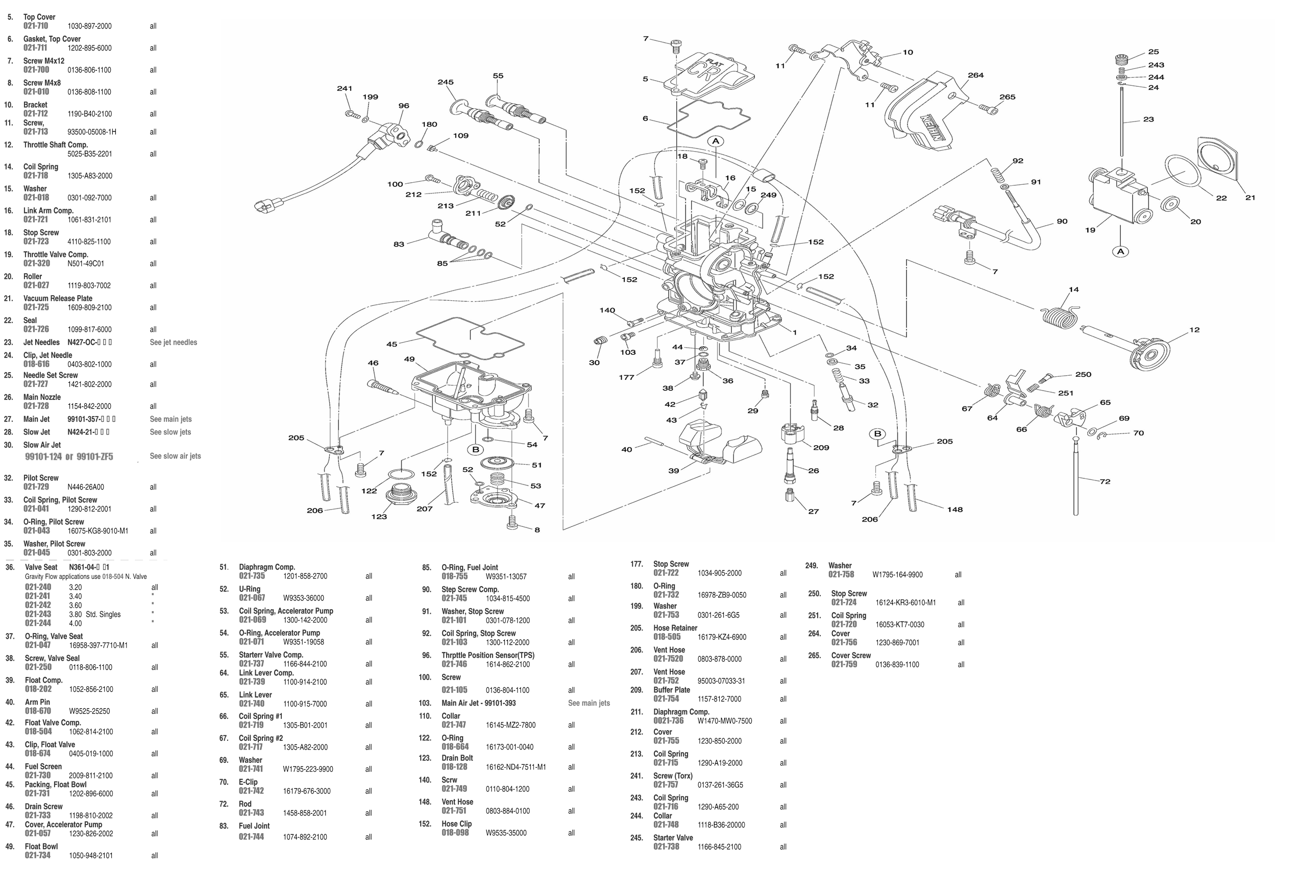

    2006 610sm dumped the whole gas tank on the ground, through the bowl overflow. I assume it is a needle/seat/o-ring issue...where do I buy the right o-ring?
    Does anybody have any tutorials? It has been a while since I've messed with the carburetor.
    Thank you in advance.

    Yep, i fixed it with a new float seal assy. I heard some fixed my problem ( on an older Yamaha 2T) with just cleaning the sealing face/seat and the float pin oring/needle. I think the oring is on the needle, I can't remember.
    It is normal for fuel to leak if its tipped too far over if the float is high, i had a bike which over time leant further and further on the stand until it started to leak. I ended up fixing the side stand and the carb was fine.
