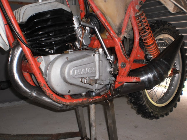

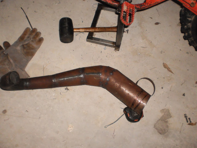

    my first attempt at pipe building... I used a cheap roller ($100) off ebay , but you dont have to have one, it just makes things easier and quicker.
    My old pipe was flattened, and i was going patch again, but decided to have a go at the whole pipe .
    I used 1.1 mm sheet metal. use a formula for the cone or make a template, make it too big and trim it down, i used a 14" cut off saw or drop saw with the abrasive blade to "sand " the sections flat once rolled . I used a 5" grinder with a 1mm blade for cutting work.
    the cone making is easier than you think.. have a go!
    As for welding, the better the fit (smaller the gap) the easier it is. I tigged mine, but some people prefer oxy.

    looks great...is that Maico a 430?

    Would you be so kind and show me what the roller looks like ?
    Thanks for posting.
