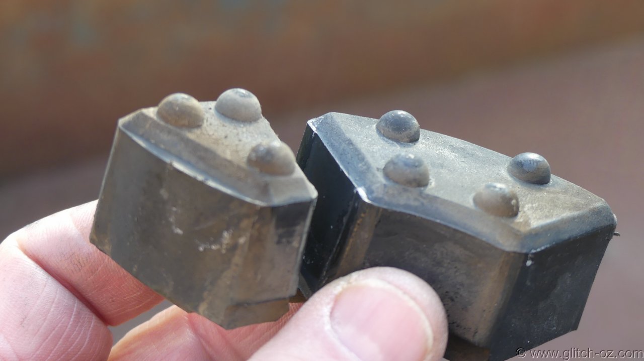

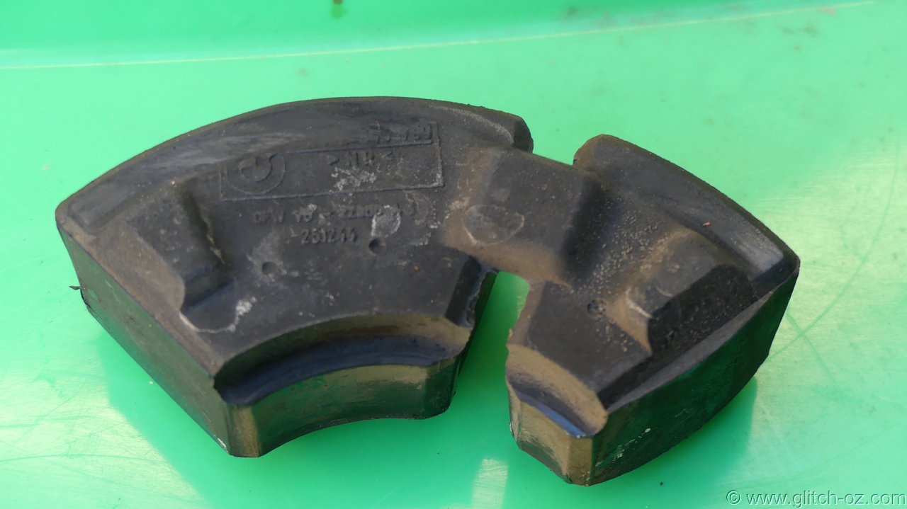

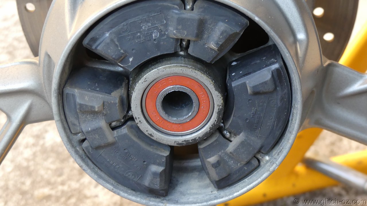

    I'm in the process of trying to source a high-density PU-replacement from some good folks in South Africa, who have been doing the replacements for the XT660R/X/ Tenere guys
    for a few years now.
    About to peel the rear wheel out on Saturday to send over some photos.
    If it happens, it'll be a while though...

    Might be best to hang onto those rubbers until we're (hopefully) past the initial contact, then maybe mail them straight to Andy in ZA for measurements etc?
    Mailing the pics off this morning.

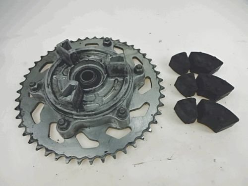

    The TR hubs/ rubbers are identical for all TR's.
    They are BMW R13 series wheels/ hubs as used on the F+G series singles:
    F 650 GS , 2000-2007
    F 650 Dakar , 2000-2007
    G650GS 2010-2016
    G650 Sertao , all years
    Sprocket carrier is the 3-prong R13

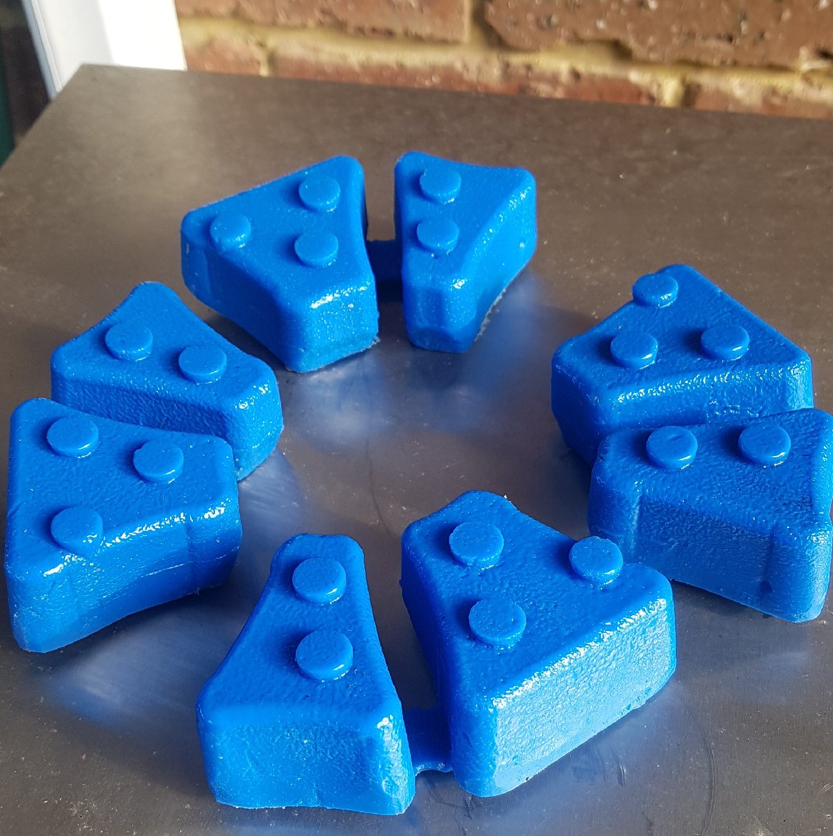

    Here's a shot of Andy's High Density replacement parts for the Yammie XT's.
    Chuffa, LED and PaulC like this.

    Word from Andy in ZA:
    Hi
    Yes we can do the bm PU rubbers that fit in the Husky 650.
    For the same price as the XT blue ones.
    ***EDIT: ****(That was $125 AU delivered. Took about a month to arrive, for the TR all the groundwork will have to be done first...)***
    Kind Regards.
    Andy
    I'm happy to stick my neck out and be the guinea-pig on this, will order them over the weekend and check with Andy if it's ok to post his email addy here for anyone who wants a set.

    These are the BMW cush rubbers they already produce (ours would be the blue one, the red one is for the X-series bikes, no idea about the black one)
    GoTerra, PaulC, danketchpel and 3 others like this.

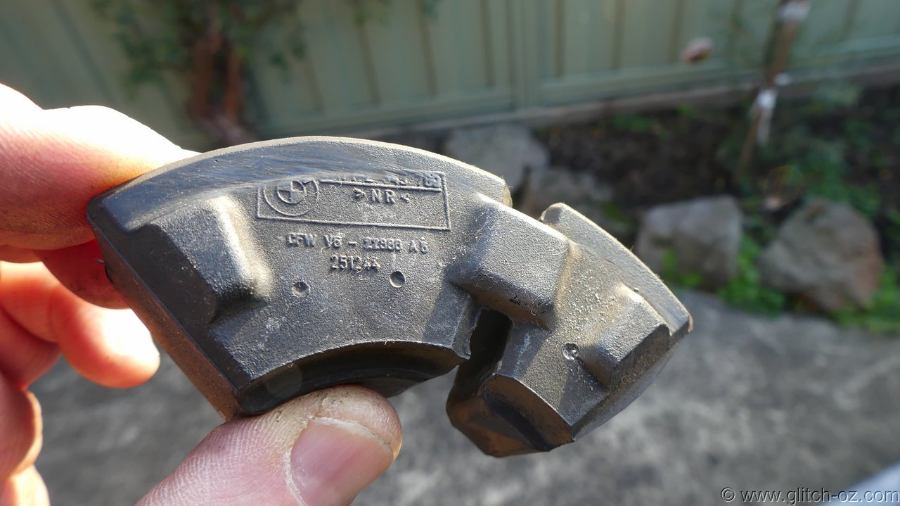

    Hey guys, got a dilema... my cush drive rubbers worn a bit and started to see some signs on metal parts. I believe need to replace them. Has anyone got an idea where I could get those anywhere in Sydney before Christmas? I am pretty desperate as planned adv solo trip for 2 weeks from 25th of dec, and just realized these are worn out. What will happen if I won't replace them and do another 5k km on those? Does anyone have these ones for sale (used or new as long as they are better than mine). Mine did 20k km. thank you.

    Indeed, it was a more or less permanent fix on my 660 Tenere as well.

    I have a set that were protected by that method since the bike was almost new. I am trying the new urethane ones from South Africa. You're welcome to have a look at them.
