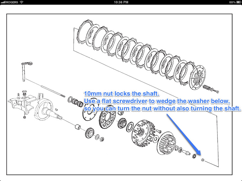

    Here's my issue. My bike does not start in gear, I have a Rekluse, have messed with the cable slack, rechecked my clutch pack and Rekluse installation, everything is as it should be. I've tried a couple different oils, still no success. After doing some searching I came across this post...
    What is this guy talking about? Anyone done it? Where is this nut, if you give me some hints I'll do a video of it since it seems the clutch drag is a common problem on the 250/300.

    Update: I emailed Rekluse, and they said perhaps my clutch center nut was too tight. I pulled everything apart and adjusted it to spec and started reassembling. In the process I lost one of the tiny little washers needed to hold in the friction disks. RAGE! So I pulled it all apart and installed the stock clutch again. After doing so, I remembered the post about the little jam nut and lengthening the rod, and checked what he could have possibly meant.
    Figured it out. I lengthened the rod by a half turn and proceeded to reassemble. Started the bike up, adjusted the clutch, and no drag whatsoever. Let's see what happens after my ride tomorrow... (I guess I'll have to call Rekluse for a new washer as well :( )

    Make sure that the little nut has at least a quarter turn before the rod bottoms out. If there's no freeplay, the clutch might slip when the engine gets hot.
