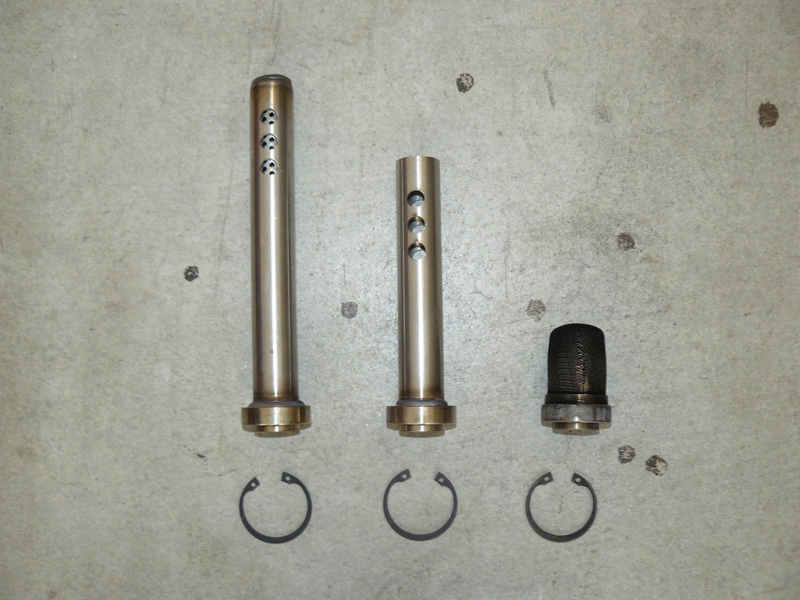

    Here are the stock Husky baffle options:
    On the far right is the spark arrestor that comes with the bike. The middle baffle comes in the power up kit, and does quiet the bike down, but has no spark arrestor. (The baffle on the far left is a part you can buy from husky. It does quiet the bike down very nicely, but is very restrictive and still has no spark arrestor.)

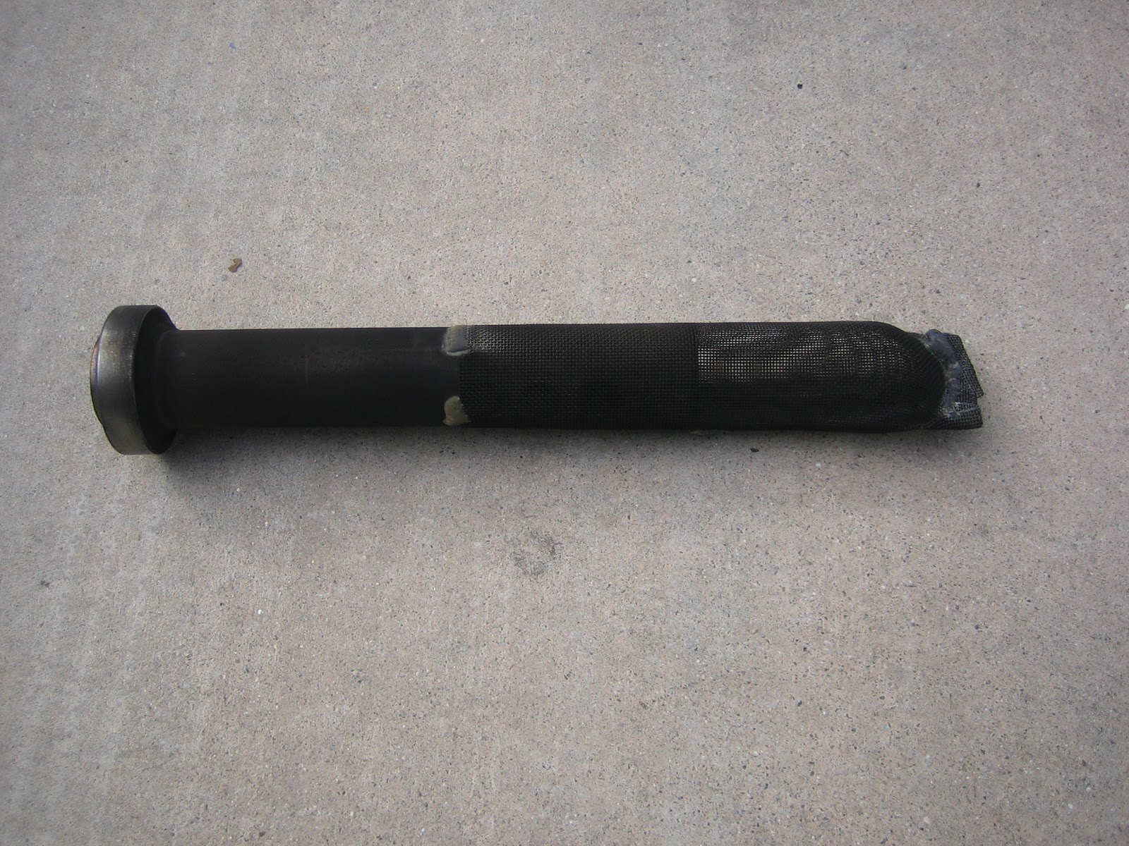

    I ended up welding a mesh screen on the end of the middle baffle (like Dan did), the one that came in the power up kit, and I've been running that. Here is a shot with the screen:

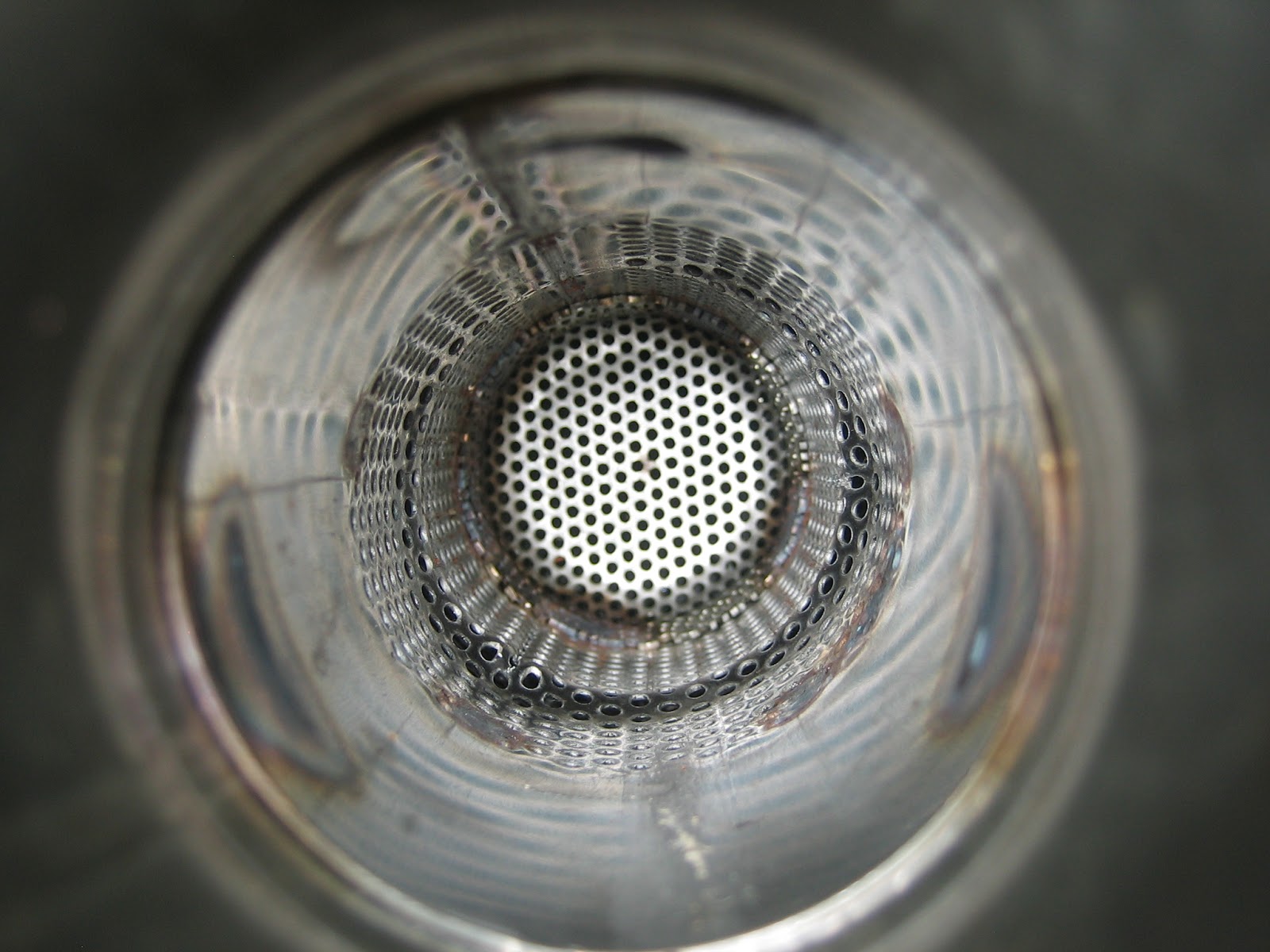

    The Q4 looks nicely blocked up inside, it's not a straight thru pipe:

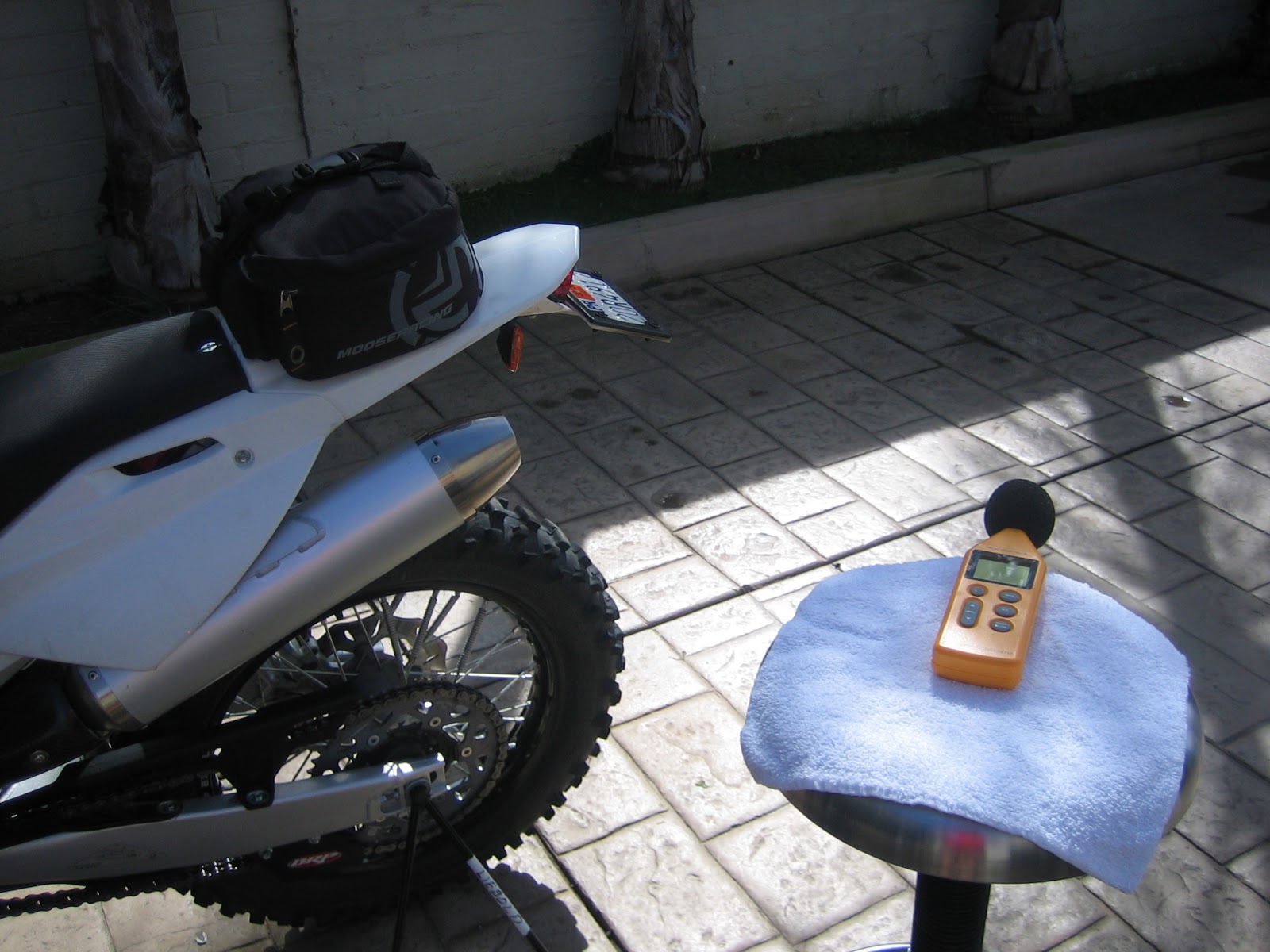

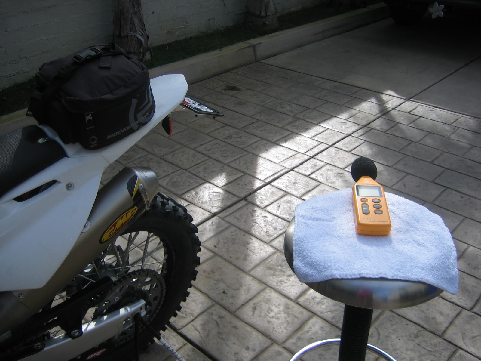

    Here was my setup. I roughly followed the AMA standard, by attempting to put the meter 20 inches at a 45 degree angle from the pipe. But my meter is a cheapo and this is not the right environment to test. All I was hoping to do was compare the two pipes. Note these tests are very rough, with me just trying to get the rpm right and then taking a quick look at the dB meter.

    By ear, the FMF Q4 sounded deeper, with the volume approximately the same as the stock exhaust.
    So essentially, my results were very similar to danbartol's. The benefit of the FMF Q4 is lighter weight and a certified spark arrestor. The Q4 is no quieter and maybe louder than the stock exhaust with the kit baffle. (Although by Dan's testing it's quieter than the stock exhaust fully uncorked with no spark arrestor or baffle. That makes sense to me.)

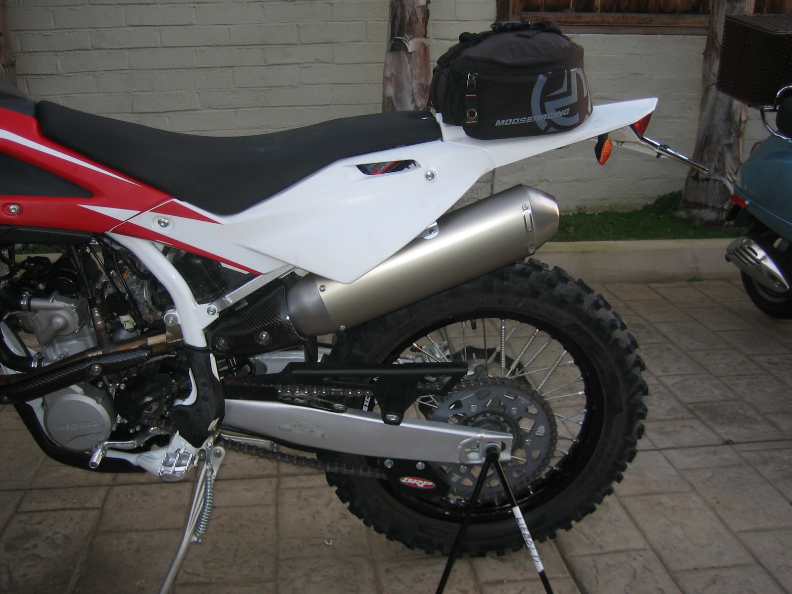

    Final shot of the installed FMF Q4 on my TE250. The Pirie CF Pipe guard took some modification to get to fit. I also removed the FMF stickers as they don't pay me to run their pipe ;-)

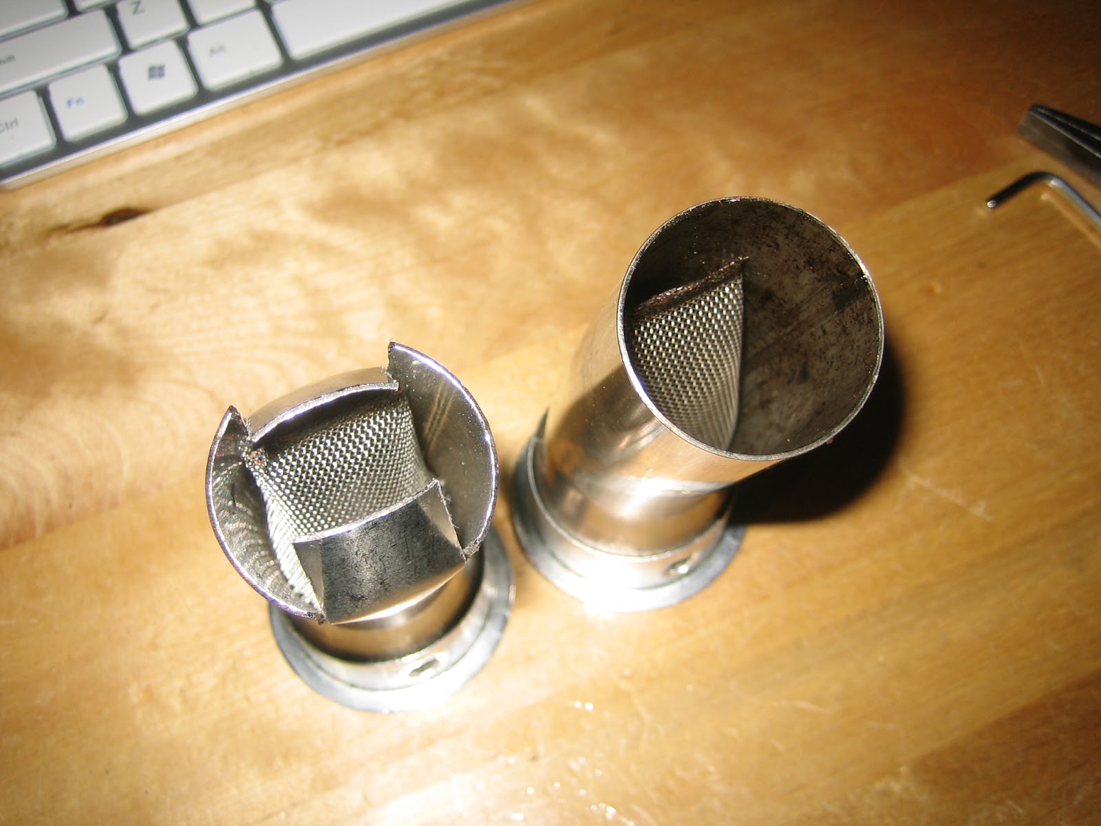

    Somewhere on the web I bumped into a great idea to modify the Q4 spark arrestor to reduce the sound.
    So I bought an extra spark arrestor for $35 and tried it out.

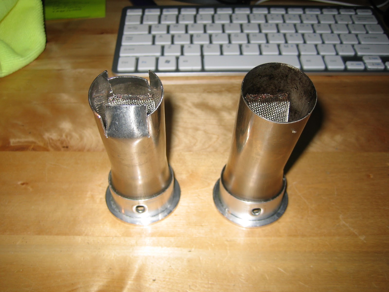

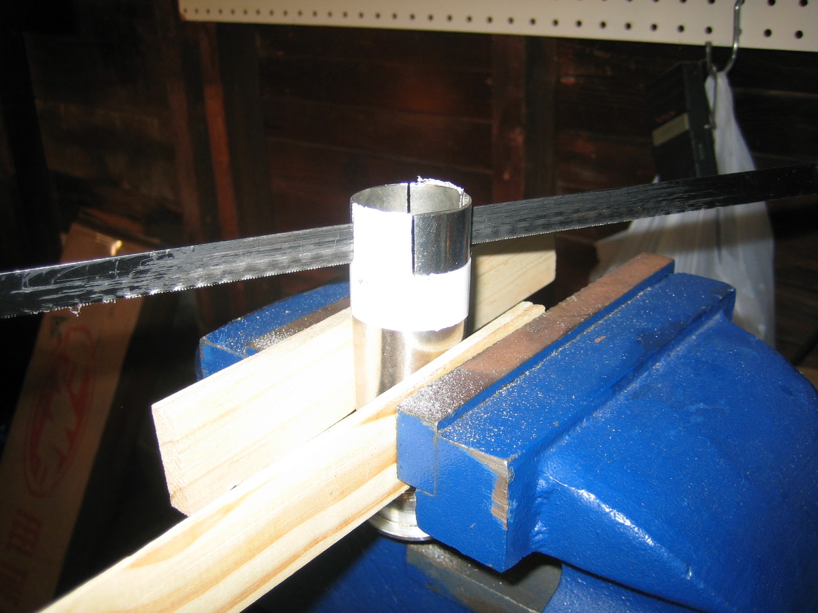

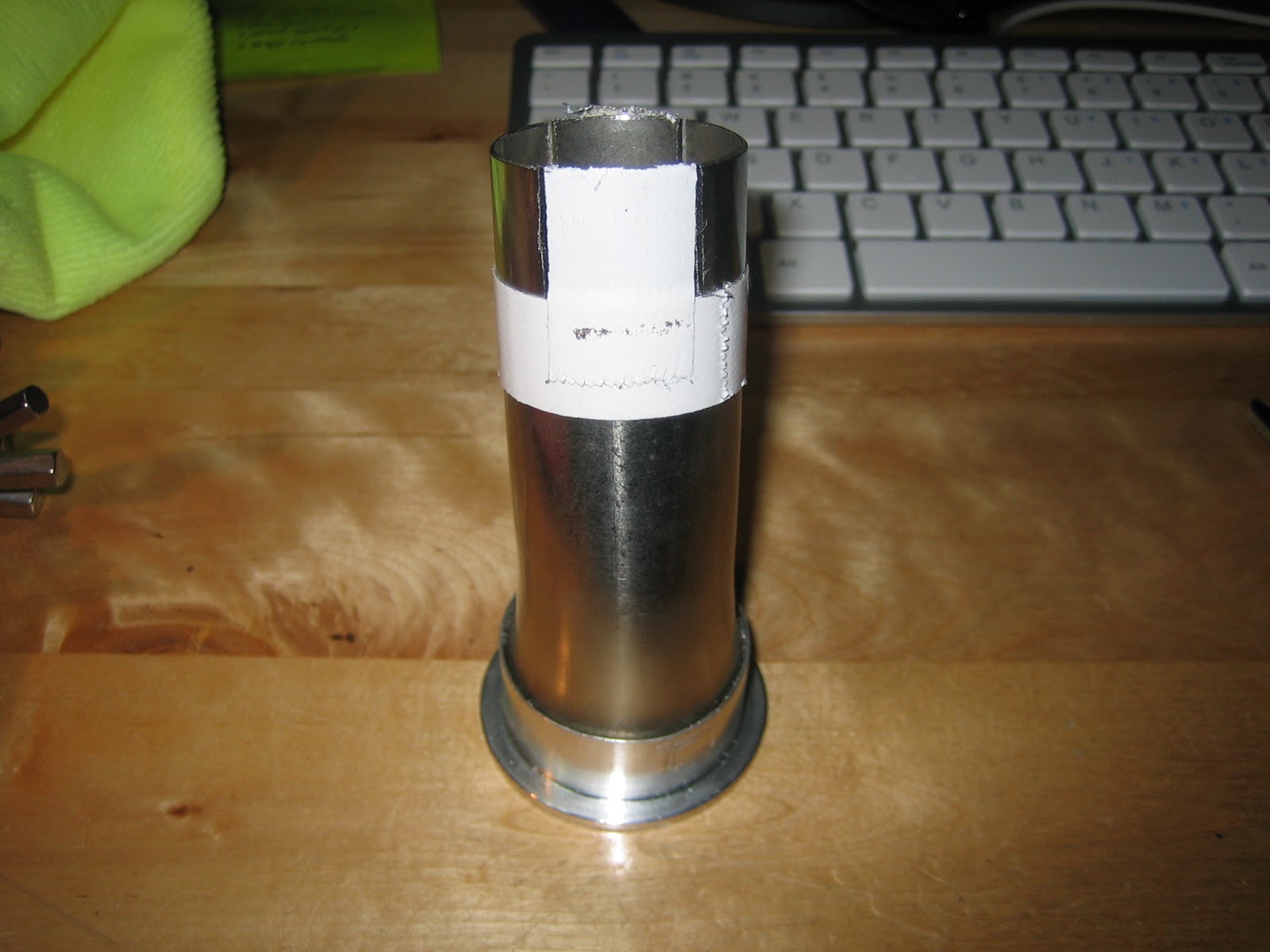

    The idea is that you cut some slots in the end of the arrestor and bend the tabs over the block the pipe a bit. I used duct tape to mark where I was going to cut:

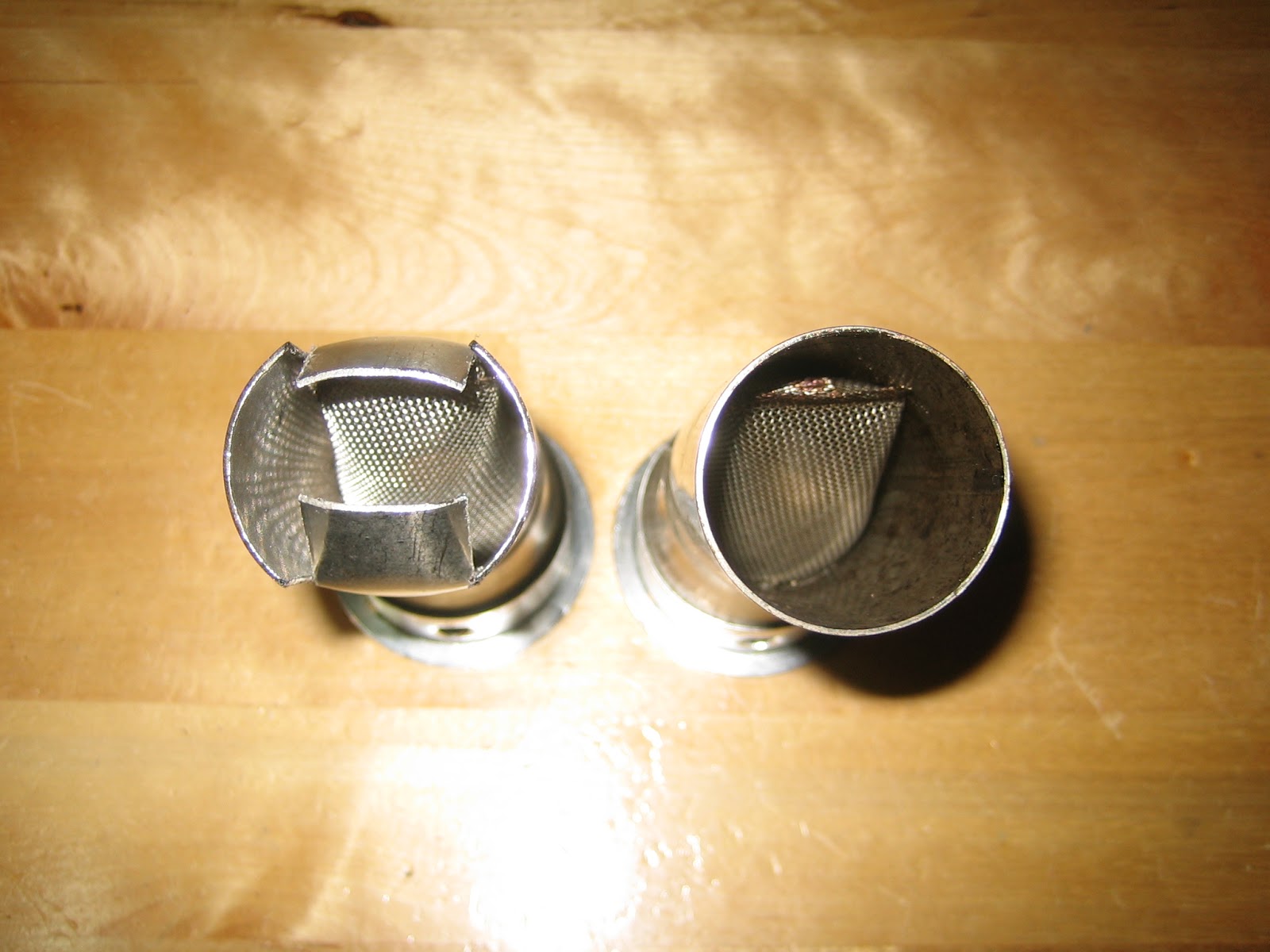

    Here are a few shots of the modified spark arrestor next to an unmodified one:
    Results:
    FMF Q4 with Spark Arrestor
    RPM Original Modified
    2000 87 dB 87 dB
    6000 102 dB 102 dB (whistle sound noticed on modified)
    8000 106 dB 106 dB
    No improvement! Wow, I really expected this to work. I guess I could bend the tabs down some more, but I don't want to crudely block the exhaust too much. I guess the lesson is that you need actual baffling, not just some blockage.
