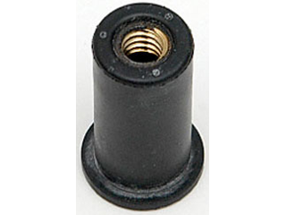

    I made inserts for the stock bar end weights out of well nuts with the flange trimmed off, some lock nuts/washers and really long bolts.
