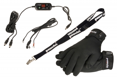

    I just got the powerlet heated jacket liner and gloves over the weekend. Very easy to wire up with the dual wireless controller. It was 47-56 degrees F in my 30 minute ride this morning and with the gear on I did not even have to turn the heat on. I wear an alpinestar jacket that has a liner when it gets colder can be added and pair of riding over pants I have had for a while. Also a pair of Icon Patrol Waterproof cloves. I think this combination should be good down in the 20's easily. When it gets colder I use a balaclava that covers my face and head to keep it warm. Only needed below 40 degrees F though. I did test the heated jacket liner and gloves on Saturday and they warm up in seconds. Only had on lower settings to make sure the blue tooth controller worked and every thing functioned properly.
    http://www.powerlet.com/img/productImages/primary/PHG-101-L_p_641_webl.jpg
    http://www.powerlet.com/img/productImages/primary/PHG-411-S_p_758_webl.jpg
    http://5cf9f959bf0963c59a2a-252b16f...d08d6e5fb8d27136e95/4/2/4238_black_1_1_19.jpg
