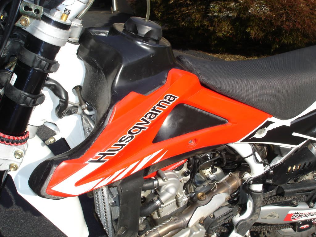

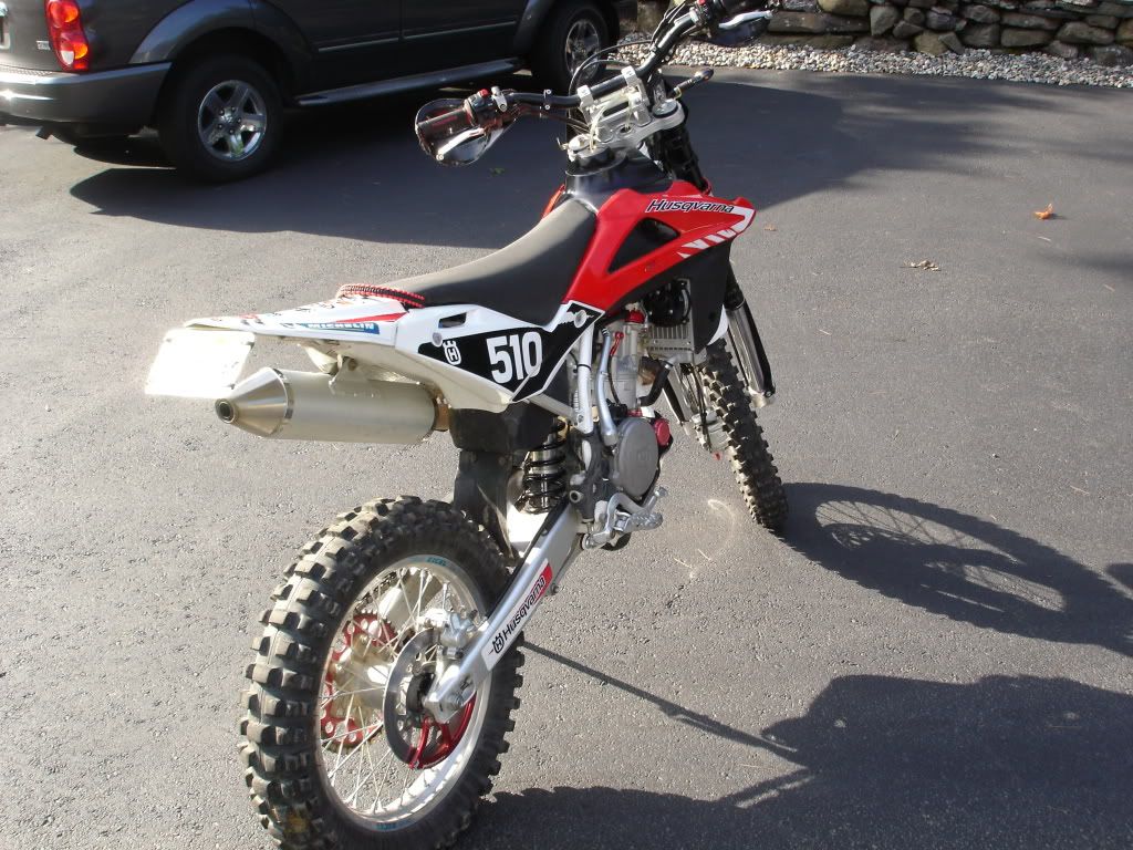

i was going to purchase some recovery straps for the husky but decided to made a set of my own out of 550 paracord. i think they came out pretty good if you ask me :thumbsup: had to match the bike with the black/red combo. now i've got something to grab onto when my bike decides to take a nap
heres a pic of the paracord wrapped up
plenty of room to get the seat off

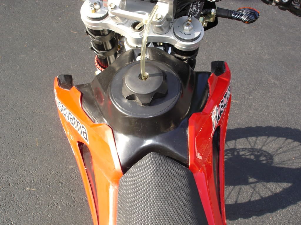

here's some pics for ya
i just fixed my graphics on the tank shrouds last night with some of my wifes acrylic nail polish. i put on a this new set on the tank the other week and the edges kept coming up. the nail polish trick worked great!!!
Those tuggers look great! Nice work. I caution you with the front strap; if you pull upward at all it will slide up the fork tube and may dork up your headlight. I suggest a single or double loop of 550 loosely wrapped around the lower triple clamp to help keep the tugger down there when your buddies start yanking hard. Hope that makes sense.
makes sense, thanks for the feedback!
