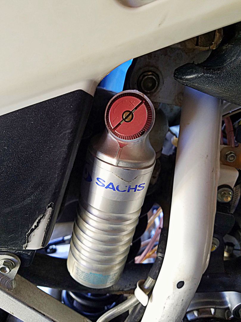

  6. apariah Husqvarna
    2011 WR300
    2008 Buell 1125r
    Sorry I missed this. A friend suggested I check the compression, and it was set as hard as it could be. The previous owner was 250 without gear, but the bike was sprung for a 200lbs rider. So adjust the compression helped a lot. I'm now trying to figure out how the reach the rebound adjustment on the shock body in the rear.

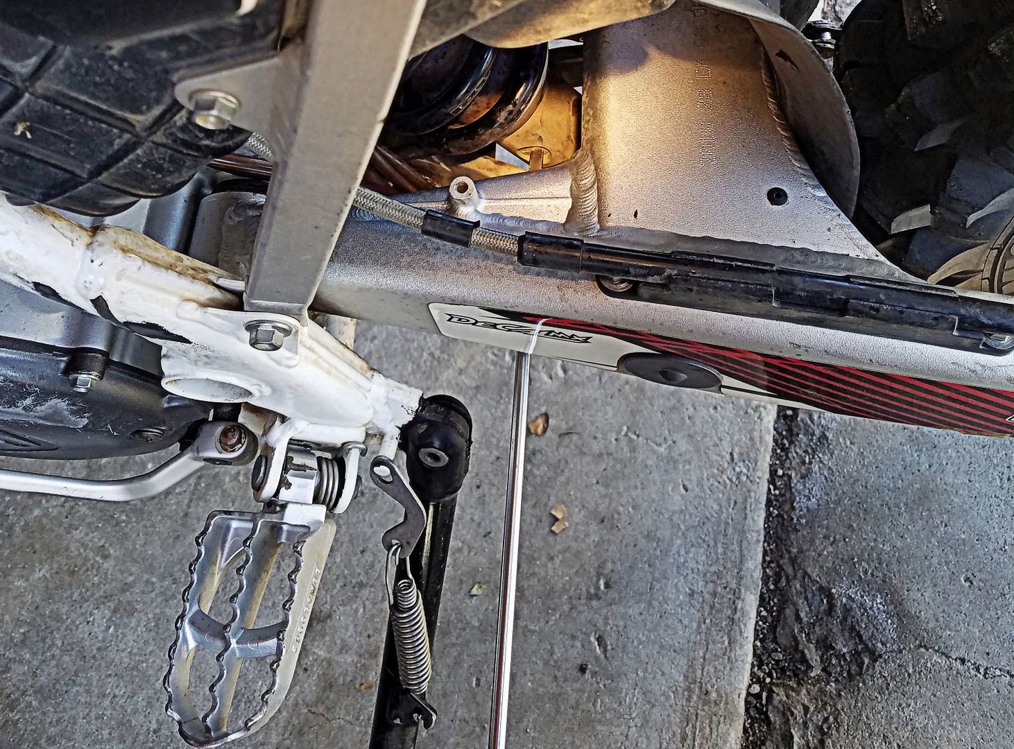

  8. Dirtdame Administrator
    Rock Springs Wy
    11 WR300,13 WR125,18 FE501
    17 Beta Xtrainer
    Just remember that the compression dampening has both a high and low speed adjustment. Red peripheral knob is high speed and little brass screw is the low speed.
    On the rebound, if you have the right spring with the right preload, you should be able to access the rebound screw with a long screwdriver when the bike is resting on both wheels. That creates enough sag to get the screwdriver right above the linkage and into the slot.
    apariah likes this.

  11. apariah Husqvarna
    2011 WR300
    2008 Buell 1125r
    The issue was the Sag. Once I adjusted properly, just as DirtDame mentioned I was able to make adjustments.
    Thanks again.
