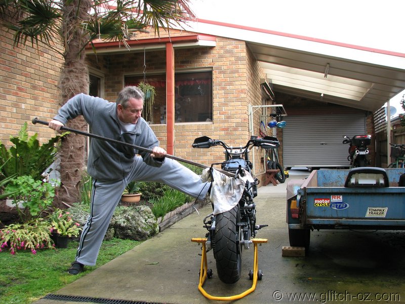

    Tools required....some old rags to prevent scratches, a block of wood or 2 and a 6ft. crowbar.
    And a pack of fruitloops/Vitabrits in the morning for some extra mumbo! :-)

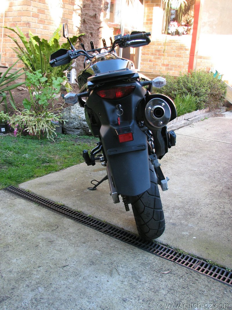

    Before:
    Don't hold back with the foul language and a bit of sweat now.

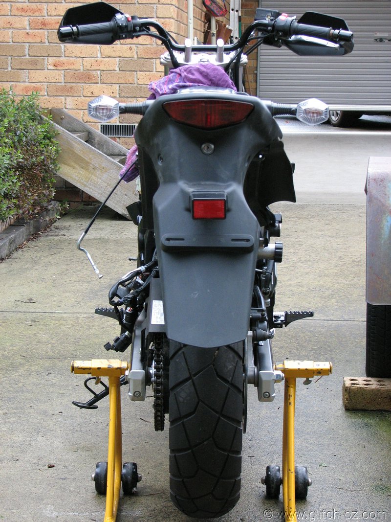

    10 mins later....
    Nip up the 4 subframe bolts again and all's sweet.
    Footpeg hanger brackets are coaxed into place with a 2lbs mallet and a piece of 2x4.
