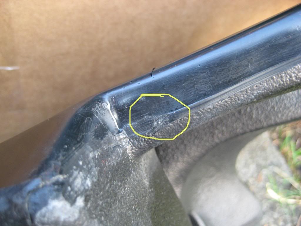

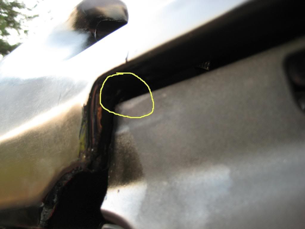

    Managed to fit it on a few days ago. Was a tight fit much like gandalf's, but managed to get the seat on with a little strategic pressure. Anyway, took it out around town the next day for about 20 miles running errands and parked it for the night. The next day I could smell gas in the garage and started looking for the source. Finally found it after opening the garage door and observing a small pool on the ground. Yep, it was the new tank. Initially assumed it was the fuel pump o-ring but that area was dry. Hmmmmm, following the trail up the right side of the engine and discovered it was seeping from the seam area from under the right wing. Slow but steady unfortunately. Called Jeff at Hall's and shot him an email with pics. Got a new one on the way, no problem! Hopefully not a common problem with these tanks:eek: Was not obvious to the naked eye after removing the tank as in a crack that was easy to see. Here are a couple of pics for enlightenment.

    In the little I have dealt with him and Hall's I've had nothing but a good experience. Was relieved to hear a new tank was on the way today as I really didn't know what kind of hassle it would end up being. On another note, I dropped in to Tasky's (my local dealer) yesterday and we were talking about the new tanks and how difficult some of them are to fit. Consensus is that between small differences in the individual bike frames as well as the tanks themselves some of them may be a real handful to install. Jeff at Tasky's recommended the hot water treatment for the difficult fitments. So.......hopefully the new one will sit on the posts a little better than its predecessor did. I really enjoy visiting with him and his wife at the store. Very easy going and down to earth folks.
