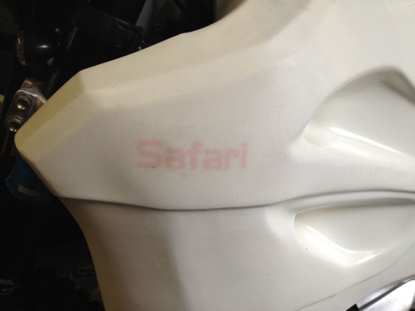

    Next project: remove that safari tank decal...
    Here's the tools:
    If Safari had a modest logo on there somewhere low on the tank I would have left it, but I don't want my bike advertising someone else's website. A bit of a "do I really want to do this?" moment:
    On she goes:
    The after. I didn't scrub it completely off because I thought I ought to leave some plastic thickness. I guess its pink, but its better than before. A few scratch marks but nothing like what it will look like after a couple of drops:
