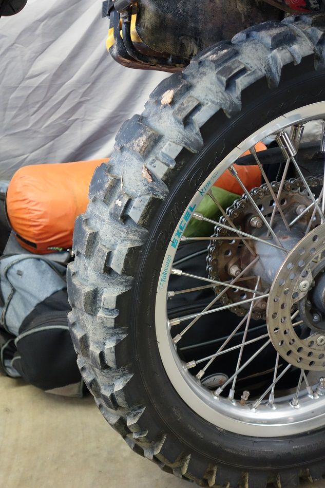

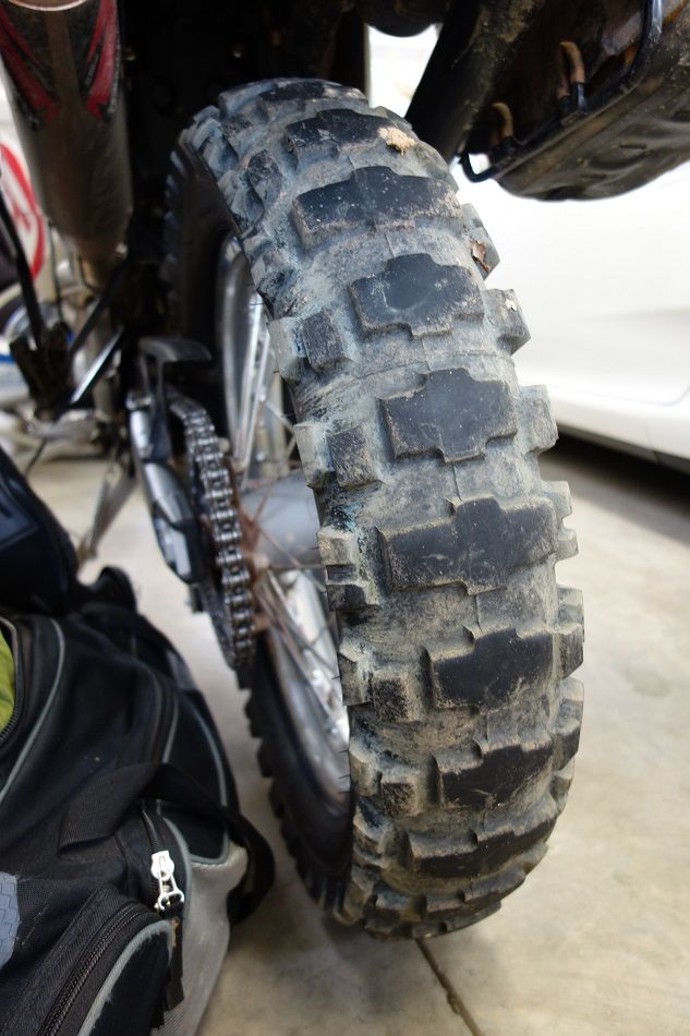

  10. DYNOBOB Husqvarna
    It's funny how different an experience two people can have. The 908 is the easiest rear tire I've ever mounted. I was dreading the job but it popped on easily, much easier than a T63 I did the same day. I've had one on my 630 for 3100 miles now, I like the drive traction just fine - lateral traction is not as good.
    3100 miles
    [IMG] ... [IMG]
