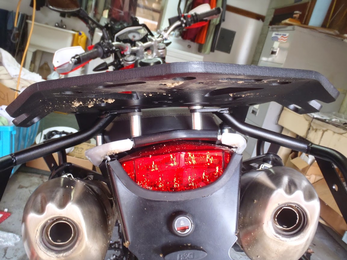

    Overall, I really like them. VERY strong, fit my Wolfman Expedition bags very well and look pretty good. I installed with a Nomadic Cycle rear rack.[IMG]
    My only complaint was that the fit was not that great. Right side fit well, left side took a lot of persuasion.
    The rack was designed to work with a stock rear rack, which I replaced with the Nomadic Rack. First thing I had to do was space for the removed rear rack. Fortunately between the 2 kits, I had the spacers.
    Installed the spacers, used the rack spacers to get the correct height.
    [IMG][IMG]
    The left side was about 3/8 inch off (in below pic, look at where the spacer sits)
    After much bending, I got the rack into position.[IMG]
    The Nomadic Rack then mounted on top. I had to get some longer bolts (Thank You McMaster Carr) Kit fasteners on left side
    A 1/4 spacer for the back, the rack fit beautifully.
    For the rear brace, it did not fit with my R&G Tail tidy, so I had to make some brackets to drop it down.
    [IMG][IMG][IMG][IMG]

    We have the same set up - nomadic rear rack and Moose racing. Mine also required a lot of bending and longer bolts.
