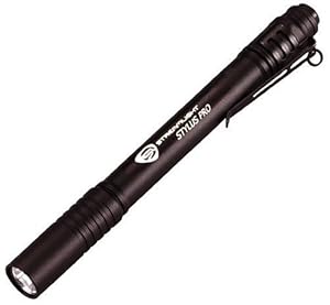

    Having the right magic wand makes it much easier...
    Oil isn't crystal clear, so you'll be able to see the contrast on the steel "cage" behind the glass. This also makes it easier to see how dirty your oil is.
