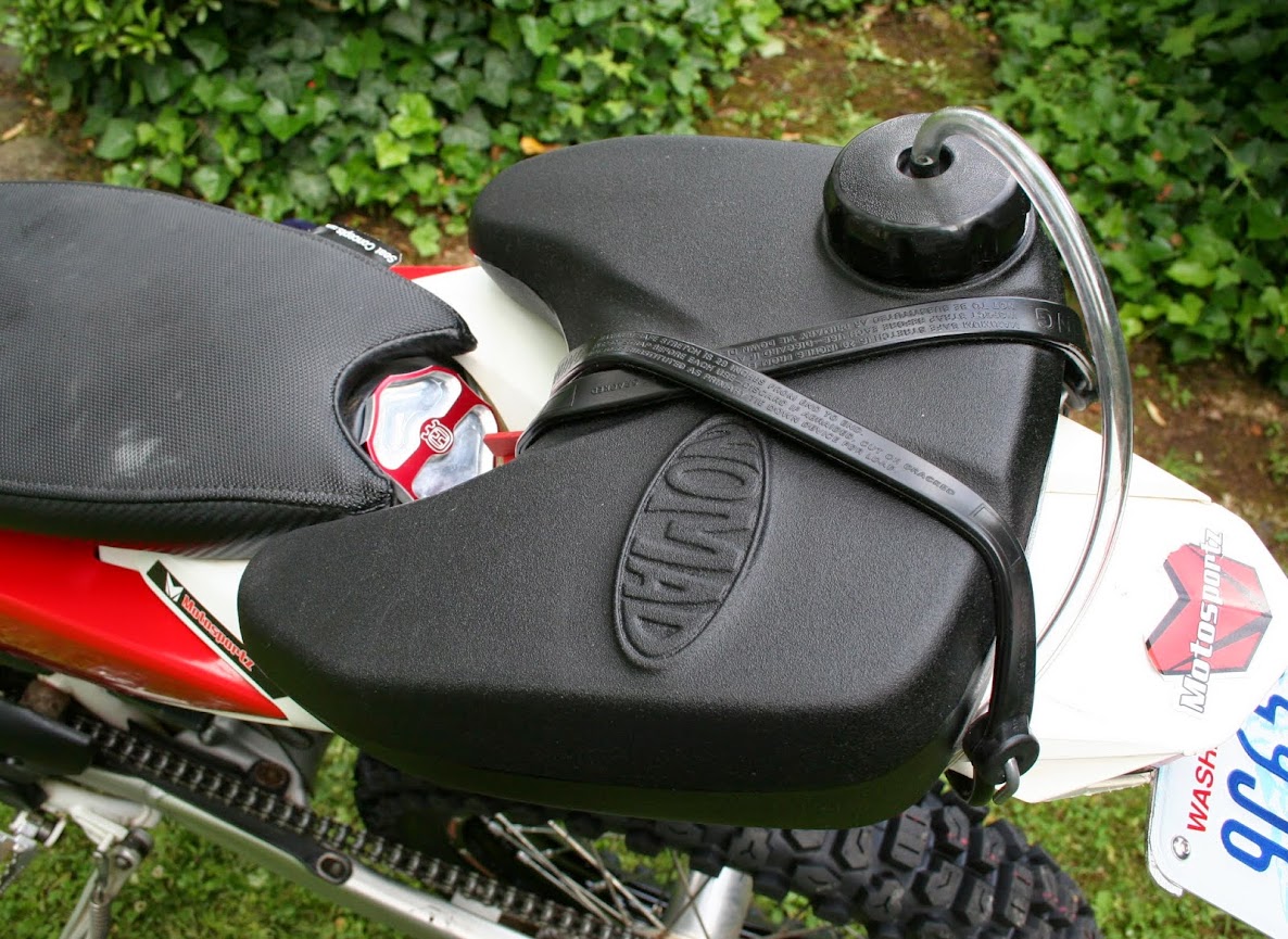

    9888sts have a look a Nomad Tank they sit on the back guard and carry 4.5lts and about $240 AUS if you look at Motospotz bike . They feed into the breather pipe of the oringinal tank. I have one and not bad just some times it smash's you on the arse over a wash out/Jump. So on a big ride I would carry 8.5lt on the bike 4.5lt on the rear and 3lt fuel cell in my back pack giving me a total of 16lts approx about 250 - 270k's.

    DM : not to dis you my white brother/red heads :thumbsup: Unleaded is .711grams per litre so there for our bikes should be lighter where is the USA there fuel is 719.7grams per litre. so with a full tank of fuel if everthing was equal there bikes should be heavier. AUS = 6.0435KGS of Fuel = 8.5lts
    USA = 6.1175kgs of fuel = 8.5lts difference .07395 .
    Dangermouse449 likes this.

    the one on the back fender is no good for me. Going over logs etc. Step long hills in Singles. I allready got fuel coming out of the breather going uphill when the tank is full. Plus when you go down ledges you lean back and hang over the back fender .
  17. Motosportz CH Sponsor
    The Nomad becomes the breather and is actually better as it does not spill out like the stock breather. I agree it can hit you in the ass when you are way back on the bike and it does make the bike handle semi funky the first 30 plus miles til the gas runs out of that tanks. But it adds a lot of distance and is EZ to take on and off quickly.

    Motosportz I run the same tank from nomad and yes it does make the bike handle alittle different , first time I thought what have I done but as you said you do get use to it.

    9880sts what about a fuel cell 3 litres in your back pack $99 dollars I use one i these and that gives me about 160kms along with the 8.5lts.
