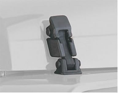

    If the width of your rack matches the width of the box, two Jeep hood latches will secure it. I did this a couple years ago and it worked great. The long part of the latch was bolted to the box, the small part was mounted to the plate on my rear rack. Two latches were more than adequate. However, I decided that I just really didn't like top boxes and sold the setup to a friend.

    Premium? Jeep parts are cheap. It's the aftermarket parts that are pricey. Ask me how I know. :lol:
    Normally those latches run for about $10-$15 a piece new. Used are perfect for this application though, and can be had as freebies from a fellow Jeep enthusiast, or for a couple bucks on eBay. This is for the part that mounts on the fender of the Jeep, or in this case, your top box. You could purchase the hood catch to mount on your tail rack, but any "catch" will do. In my case I just had a set laying around. You could just as easily weld a small catch onto the tail rack and it would work. All this, of course, assuming you had a metal tail rack.

    Thanks RD for the idea on latches. I may not use "Jeep" latches, but hood latch's are a design I can live with for strength and quick release from the outside. Now if I can find locking latches I would be set. I was wondering what the best way to mount my Seahorse Case to the rack I am going to build, and this is a perfect solution. I'm picking up the tubing tomorrow to start fabbing.

    This might work.

    I bought 2 of these southco K5 locking latches, now I just need to knuckle down and make the rack. The K4 might work better, being a bit smaller.
