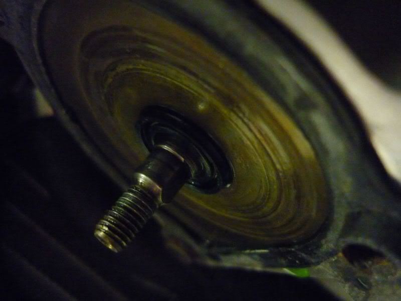

    I believe I have found the source of all my troubles.
    Water Pump Impeller......
    Looks like the nut that holds the impeller onto the shaft came loose, causing play on the impeller which eventually sheared its key. Luckyly the impeller is aluminium and the shaft apears to be undamaged.
    Here is the shaft, look at the scoring on the head from the loose impeller:
    http://i126.photobucket.com/albums/p...Pump_Shaft.jpg

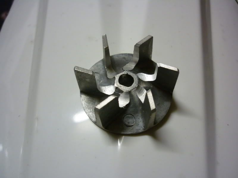

    Here is the back and front of the impeller, you can see how it has sheared:
    http://i126.photobucket.com/albums/p...ler_bottom.jpg
    http://i126.photobucket.com/albums/p...peller_top.jpg
    New impeller $77, new water pump gasket $12. Will have to wait 3 days for it to come from one of the eastern states.
    Hopefully this will cure my issue.

    Here is a picture of the new impeller, you can see the key all shiny and new
    http://i126.photobucket.com/albums/p...X/P1000950.jpg
    http://i126.photobucket.com/albums/p...X/P1000951.jpg
    I applied some loc-tite, but I also had to replace the nut as it was stripped
