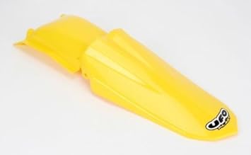

    I wanted to order a rear mudguard for the SM610 (yellow) but every online shop I checked said that this part is no longer available. Are the SM510 rear mudguards equivalent to the SM610 one? So can I order a SM510 fender for the SM610 or does that not fit to the 610?
    Or are there plastics from an aftermarket manufacturer (Acerbis, UFO Plast, Polisport...) for the SM610? I checked them all but I found only parts for the 510, 450, ... etc

    [IMG]This is the rear fender for 510. If you trim off the underseat part of it which on 610 is a seperate and apparently diffrent design it fits like a glove..ah and its more flexible than the OEM...it bends without breaking in half...30 € or aboy 32 bucks in the US I guess.
