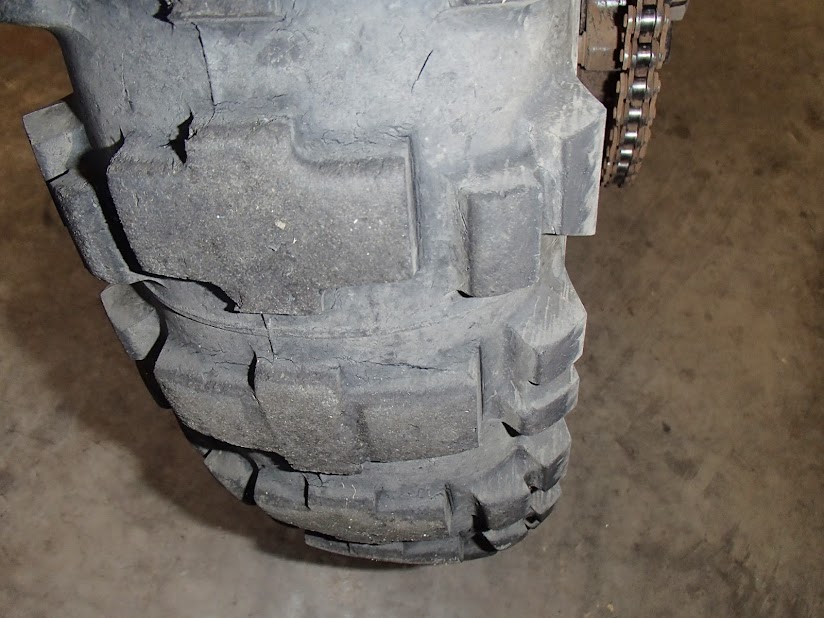

    This previously used half rooted d908rr
    Did this-
    How hard would have a new tyre srubbed? Glad I didn't fit a new d606 as they are taller again.
    So hoping to get the rear suspension upgraded/modded to stop this happening, and hope to run a d606 rear tyre.
    Anyone else seen this scrubbing? I was trying hard to keep up with some WR450's on some fire trails :o

    Pretty sure from memory that the secret compartment was only just touched.
    The worst rubbed bit was fuel tank.
    Maybe I just got a dud. The chain tension be a facter, my F..A.. is for sure.
    The other difference may or not be my bike is still new with an unworn chain and havent dropped a tooth from the front sprocket (YET, it's in the mail). So removing that alarm case might help after all.
