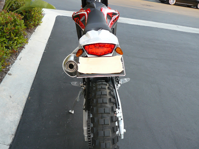

  10. Rizzkid Husqvarna
    2012 Te310
    KX250
    0102132050a.jpg Just trimmed mine a bit, installed an LED bolt plate light and removed the spacer blocks on the turn signals so they do not stick out so far. Total cost $6.99 from PEP Boys for the chrome LED light.
  11. vintageveloce Husqvarna
    Southern California
    2010 TE250
    Just pull all the black plastic stuff off and mount it like this:
    Note how nicely the turn signals are tucked in. I've crashed a bunch with no issues. In the top pic you can just see the tips of the front ones poking out past the forks.
    Get them here:
    http://sicassracing.com/store/products/turn_signals/led
