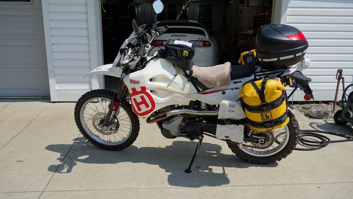

    In fairness to Safari tanks, there were quite a few who had fuel leaks with the stock tank. Mine and my buddy's Safari haven't had any problems.
    With my TCI rack I can slip a Rotopax on each rear footpeg and strap to rack arms coming to the footpegs. Keeps weight low and central. I did this several times with the stock tank, not yet w/ the Safari.

    No leaks on my safari tank and it has been out in temperatures over 100 F in Morocco and below 22 F over is the sunny UK with no issues. Doubles up as radiator protection quite well, tested on more than one occasion.
