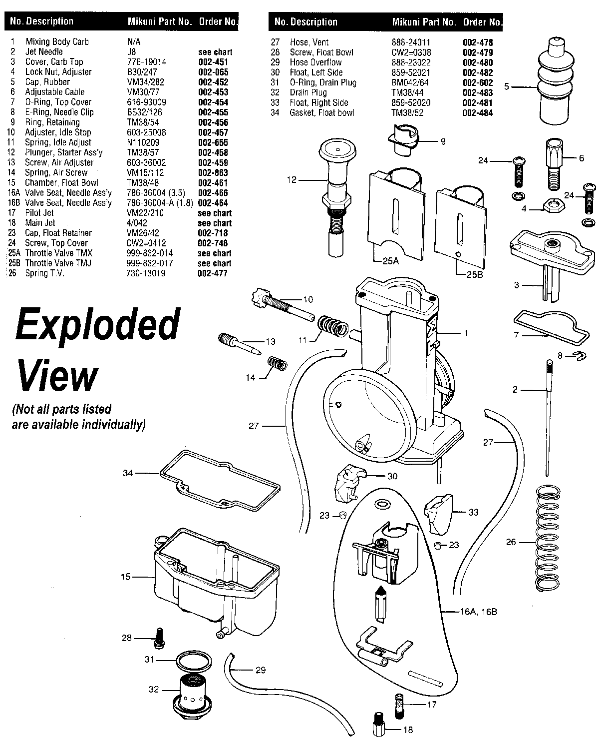

    That's a TM carb, I couldn't find a exploded view of the TMX on our bikes, I do have an exploded view of the TMX, I needed to replace the needle/cable retainer, it got ordered through Honda and got a spare just in case. I'll see if I can get it posted on here

    There are 3 styles of tmx carbs. First gen has a slide that looks like a half round slide, the second is a flat slide that my 07 wr250 & honda cr250's use, the third is the new kidney shaped slide that 09 & newer husky's use, some times called a tmxx. The cr250 does not use a tm carb, the slides look similar but are not interchangeable.

    You can down load the parts manual for your bike @ hall's cycle & husqvarna outlet web site, maybe more. The manuals have exploited parts views & all the part numbers.
