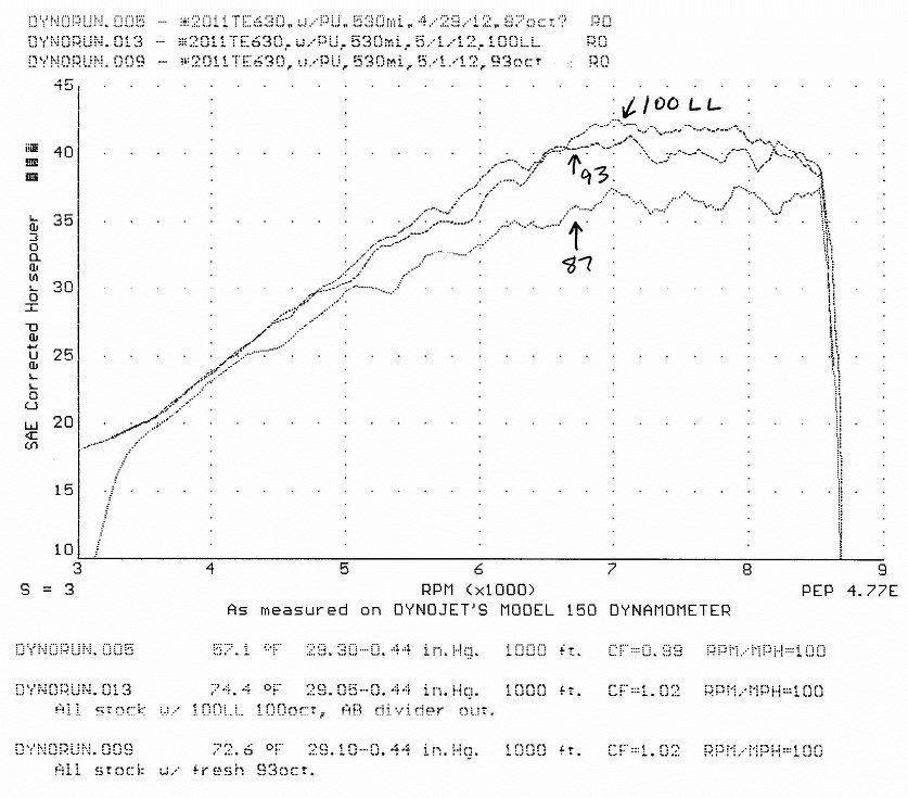

    We'll have to disagree on that. It's going to require time consuming disassembly and is not something most of us want to do, especially if we're 2000 miles from home on a trip. Furthermore it's not something that should happen on modern vehicles in a correct state of tune. ...Maybe it's not a big deal to a mechanic that gets paid to do this stuff every day. :)
    I know I sound like a broken record, but the 630s are very lean on the big end if you're not adding fuel somehow. A bad tank of gas or wrong octane and you're really hammering things in the engine. Maybe it has nothing to do w/ fueling, but when I read that someone has had two failures in a couple hundred miles I'm asking myself why and trying to help. That's why I asked the OP the fueling question. An engine w/ 1500 miles should not have a blown head gasket.
    There's anther thread here where rod bearings are hammered at 7000 miles ... same thought.
    My bike w/ just PU kit - all those pulls are wicked lean.
    The 93oct "lean" pull vs. proper fueling.
