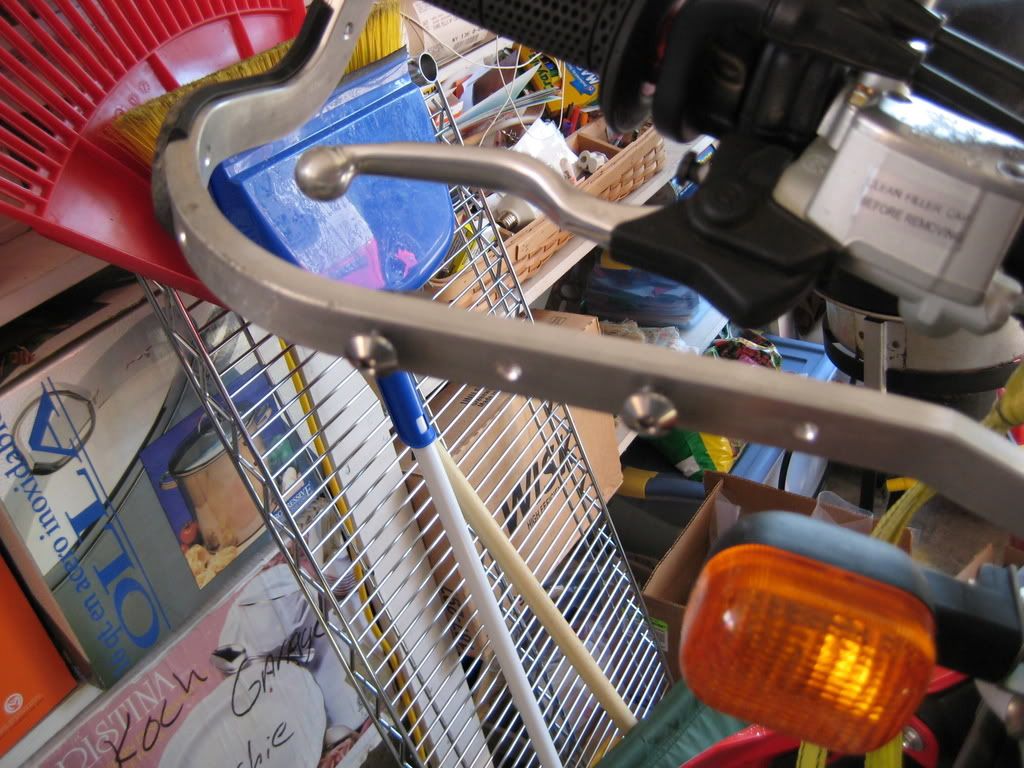

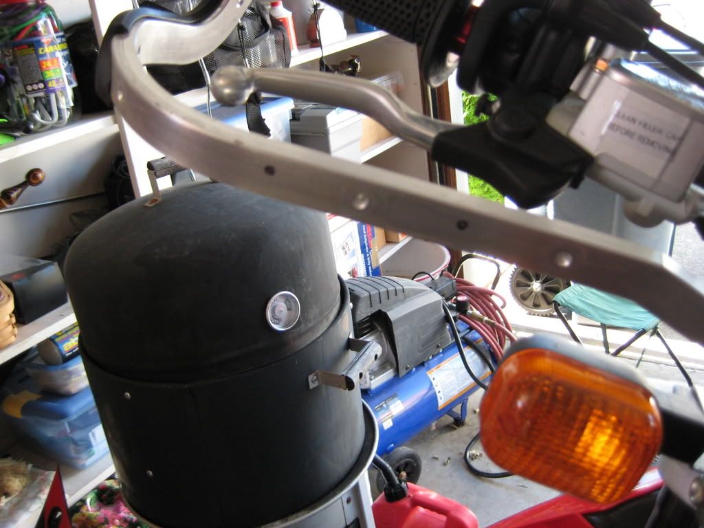

    Well, a while back on TT I promised to give these shields with integrated signal lights a try on my Cycra busters so here we have it!

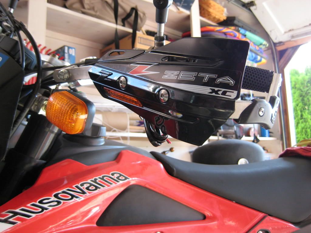

    The bolt holes of the stock Cyra shields and the Zeta's are nowhere close to each other. Not a problem, I marked, center punched, and drilled new holes with a 13/64th bit for the Zeta's 6mm Allen screws/bolts. Followed the drilling with a 6mm x 1.0 pitch tap.
    The Zeta's new bolts worked just fine in the threads so finished drilling and tapping both sides.
    Installed the shields, cut and terminated the 2 wires from each side with the included crimp-on bullet connectors, zip tied the wires securely and Shazaam!
    The blink rate is faster than stock blinkers but they blink and I've no longer got broken, gaudy, stock blinkers sticking out there waiting to be snapped off. (3 of my 4 stock blinkers were trashed in the first few rides off road in the "bush") Thanks fitness2go:cry: ,hehe. Also, the last picture shows that the Zeta's aren't as big as the Cycra shields, in height and width, leaving the outer 1-2 inches of guard exposed. I don't know the impact of this yet as temps haven't been low enough here for me to feel a difference.

    Oops, thanks Coffee, you got me on that one. Took the picture before the job was done. Does give a nice comparison though:doh:

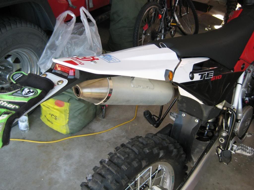

    Are you using LEDs blinkers in the back?
  5. ioneater Husqvarna
    NW Texas
    2010 TXC 250
    08 Sprint
    Yes, I installed the "power up kit" UFO taillight and dumped the stock blinkers for some REALLY low profile LED's. Not DOT by any means but....the price was right, lol.
  6. Coffee CH Owner
    Maybe a different flasher unit designed for LED lights might blink them at the proper rate? I've never looked into that, but understand how a blinker works.
  7. Poopy Husqvarna
    Kamloops, BC
    WB165
    You need to put a resistor in the circuit to have LEDs flash at the proper rate.
  8. ioneater Husqvarna
    NW Texas
    2010 TXC 250
    08 Sprint
    Speaking of flasher, I couldn't find mine for the life of me. Searched here and TT for some guidance and the closest I found was behind the headlight. Couldn't locate it there or under the gas tank, plus I didn't really know what they looked like on a bike. Asked Jeff Tasky at the dealership when I was up there and .......................it's back near the battery on the left side next to the positive lead. Well it's supposed to be, anyway, but mine was dangling down in the airbox. Thought it was a sensor of some sort:excuseme:. He and one of the mechanics also suggested just swapping out to a different flasher from the auto parts store and the rate will drop back down. I'm just happy they worked!
  9. Motosportz CH Sponsor
    That looks great. I also went to really small LED rear blinkers on my 610. I love how bright they are / will not be missed.
