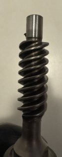

I pulled the starter assembly and found out some interesting things:
- Continuity check on the motor failed
- Somebody replaced the stock gasket on the starter assembly with some kind of liquid / silicone gasket, which blocked the oil port
- Worm drive looks perfect
- Starter motor had some nicks / scratches on the body
- Motor drive shaft was completely seized - tried turning it with a wrench, which worked, but it makes grinding noises
Couldnt look inside the motor yet (no fitting socket - 5,5mm?) but i think the magnet is shattered.

Starter motors are shit on these bikes they generally last 25 starts then slow down wearing out the mechanism, I had 3 before I gave up & went kick only, if I could find a motor re-winder to maybe work some magic with better / heavier copper or maybe adapt a newer starter motor id do it, there is a full set up on almost perfect valve clearances which works well.
I opened the motor and it was completey destroyed, don't know what happened there.
I now went kick only, removed the worm drive and wheel an plugged the hole with the cover 8000A7010
