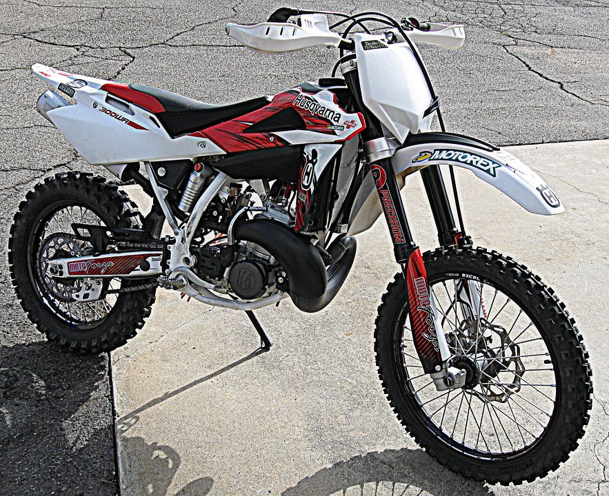

I have a WR300 2013 that seems to have everything it needs to start.
It backfires and kicks back, and only starts if its cold after maybe 900 kicks.
Its got 150psi of compression
0.8mm base gasket
Brand new piston
Crank bearing seems good, no up/down play
crank seal (atleast on stator side) seems fine
Good spark (With the lights disconnected) Without the lights disconnected its a bit meh
Woodruff key is fine
Tried several plugs, new and old.
Clean carb with a 40 pilot jet.
Carb is getting fuel
No obvious air leaks such as a cracked intake.
Maybe 3 week old fuel.
Reeds don't have any visible faults.
I'm kicking the way you're supposed to. TDC and all.
I'm thinking its timing at this point but id like to ask what you guys think it could be.

Try a fresh sparkplug wire and NGK silicone waterproof plug boot. Don't kick from top dead center. Bring starter down about a third of the way before kicking. The WR300 is a finicky starter. Haven't used my 300 for a while, but it worked much better with a #80 starter jet, 37 pilot and a JD Tuner kit complete with a different slide.
And make sure that the kickstarter is mounted as high as it can go for maximum kick travel. Kick starter shaft should just be touching the expansion chamber ever so slightly.

Its got a brand new plug "hat", But not cable.
Do you think the ignition kit could get rid of the "finicky starter"? And the JD kit is hard to find for my exact model from Europe.
Ive been kicking this bike so much in so many different ways. Literally the times ive had the most luck is when ive been kicking it from off of the bike (Literally kicking, not stomping the kickstarter)
I wonder what starter jet i have in it. Havent checked, likely original.
Ill give your suggestion a shot! Tho i have my doubts.
Update:
It was the ignition system causing the whole issue!
Swapped it with a HPI one and it started right up!
