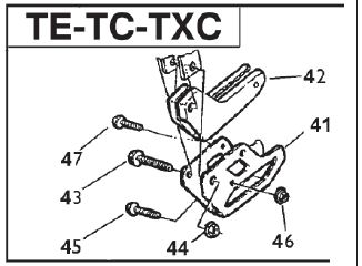

Only 1300 miles on my '09 TE310.... Is this common??? (See Pic)
Do I need part #41 - Bracket, #42 -Chain Guide, or both?
I'm thinking both... Just looking for confirmation before I call Halls.

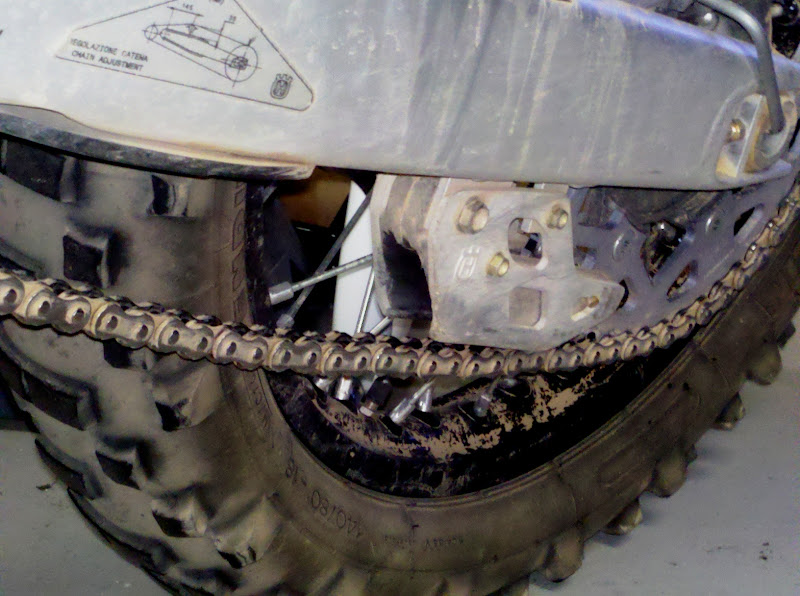

Not so common unless you are wearing the inside plastic piece on the outside or inside..Then the aluminum is bent or not centered on the sprocket.
If it is wear on the bottom then the chain may have been loose for a while.. If the aluminum part is good then only # 42 is needed

well just looking at your picture the chain is to loose and has worn through the plastic guide and then through the alloy bracket..... so now you will need both 42 and 41..... keep the chain tight and you will only need to replace the guide 42 in the future
ps ...replace that sprocket it looks worn
happy riding H.B
Wow looking at the guide you not only need a new complete guide,but also new gearing and a new chain.I would have thought you could hear it when it was sawing through the aluminum part of the chain guide/guard.The other thing I have seen in the past that could do this is a gearing change to a larger rear sprocket without changing the lenth of the chain to move the axle farther back in the swing arm.
WOW... For some reason the lower picture did not come up the first time I saw(rather you sawed thru)the whole kit and ba buttle.
