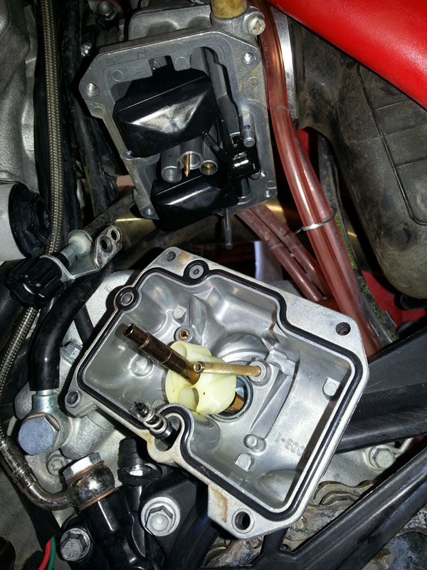

Lately my 2007 TE510 hasn't been itself. I have notice that my spark plug is fully covered in deep heavy thick black carbon soot. I have bumped up the heat range and installed a fresh new air filter, changed the oil, but same problem. I haven't done a thing with the carb jetting, I figured it shouldn't be a problem since it has been fine for the past 5 years. I tried to do a compression test but because of the auto decompression feature I could only get about 80 psi from the reading.
Any suggestions? I only have about 6k miles on the bike. Does anyone know how to actually perform a full/correct compression check without the interference of the auto-decompression feature?
What else do you suggest, what are my options?
Thanks in advance, Ron
