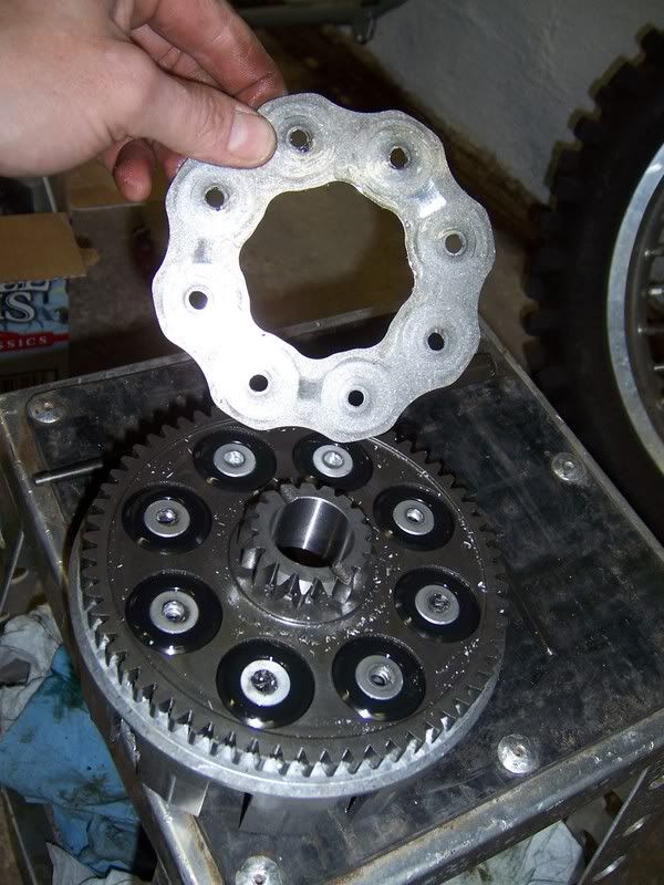

So I read through several threads that say the 2006 and earlier bikes had a Cush Clutch as shown in this pictures:

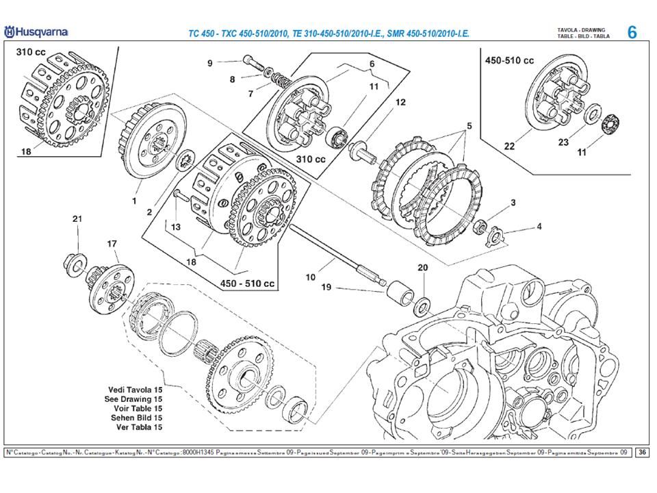

What about the newer bikes? When I look at the 2010 parts diagram I see no cush/rubber dampers anywhere in the clutch?
The rubber dampers should be mounted on Part #18
Dan,
looks like its shown as an assy under one part number(18). we have the same type items in aerospace. You can drill and diassemble and find all the sub assy parts, but can only find those individual parts on the original mfgr drawings that break down the assy itself. The basket may be built in house or from one of the many OEM clutch suppliers like Adige or Surflex.

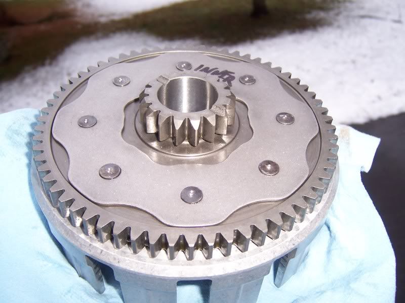

That's a really interesting post. I'm wondering as the drawing lists 450-510cc, if the 09 SM bikes had this?? Looks like it took some getting that cover plate off. I thought it was a harsh direct drive, the clutch idea is excellent. Someone must have the answer
I would assume that the rubber dampers are a wear item like they are when in a rear cush hub. They are a replacement part for the KTm 950s and 640s.
There is no replacement part to order, so back to the drawing board.
