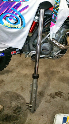

I have removed one of the forks only.Will continue tomorrow changing the seal and oil.
I could not remove the wheel shaft from the wheel:
I tried to knock it out but it was stuck.
dont try to knock it out, you will damage the bearings if they are good. did you unscrew the axle apart?? it is 2 piece

First fork is done (all i need is to fill it with 0,5 bar air).
Wheel shaft splitted in two pieces also :D!
