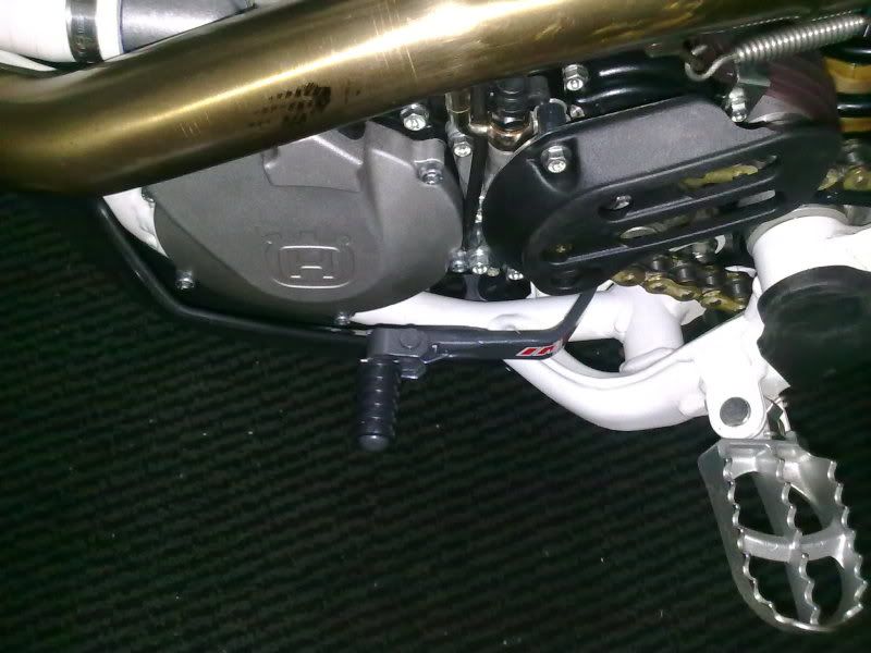

Just put a YZ250 IMS gear lever on and fits a treat. Didnt like the standard husky lever at all. Far too long and all the bends in it were not needed. Husky havent changed their gear lever for decades, and that coupled with the tiny x light motor, it just didnt fit right.
IMS YZ250 '96 lever fits perfect and is tonnes better IMO
Heres a couple pics
Is that lever any shorter than stock? I think the stocker is on the long side and would like something a little shorter.
It looks like it tucks in better, too.
Those steel shifters can eat the shift shaft be careful to keep them tight.
The stockers just wear the shifter splines when they get loose.
I think the stock lever is bit too short!?
The IMS lever is shorter than stock. We found the standard too long, but after a while we just got used to the standard and have stuck with standard!
+1
I've seen 2 IMS shifters ruin the shaft spline, and both bikes ended up getting tig welded to salvage a ride weekend or vacation.
