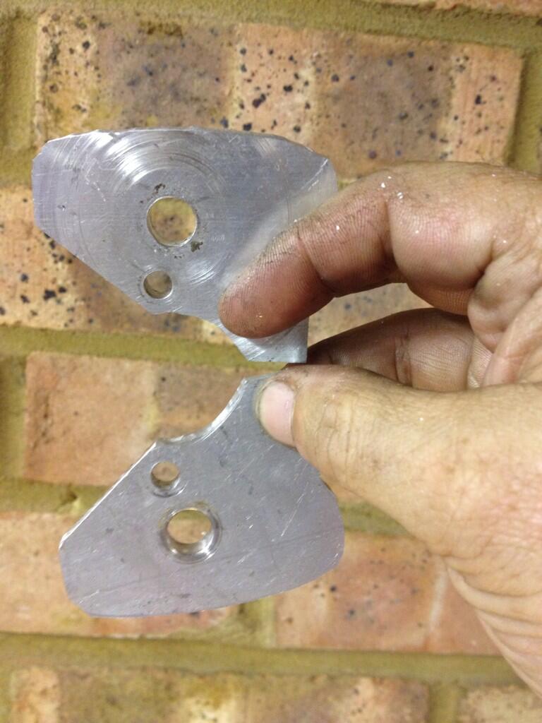

I spent yesterday in my workshop fabricating a couple risers to lift the bracket/mount up enough to clear the nut, and also a turned a couple of spacers that replace the rubber inserts that the bar bolts normally go through, these needed to have off-set holes so the bolts line up with the damper mount.
Hand milling complex shapes is an interesting challenge!

As I'd lose a little vibration damping, I'll sandwich the spacer plates between some thin rubber. It may not offer much in the way of vibration damping, but it will also allow a good snug fit between the surfaces.

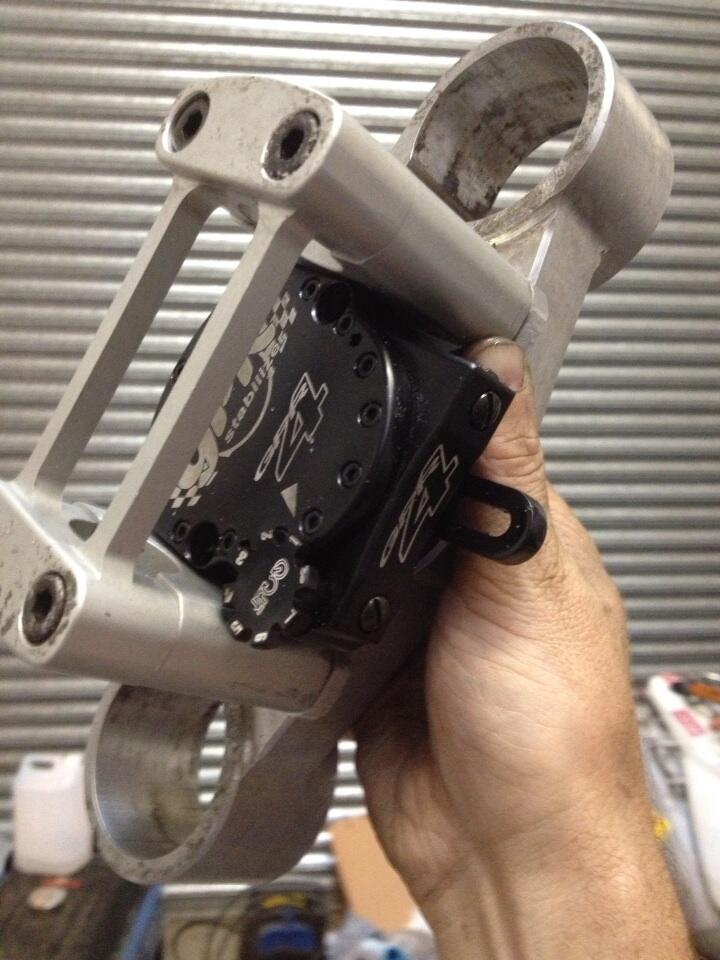

Here's the yoke and mount as it is now.
