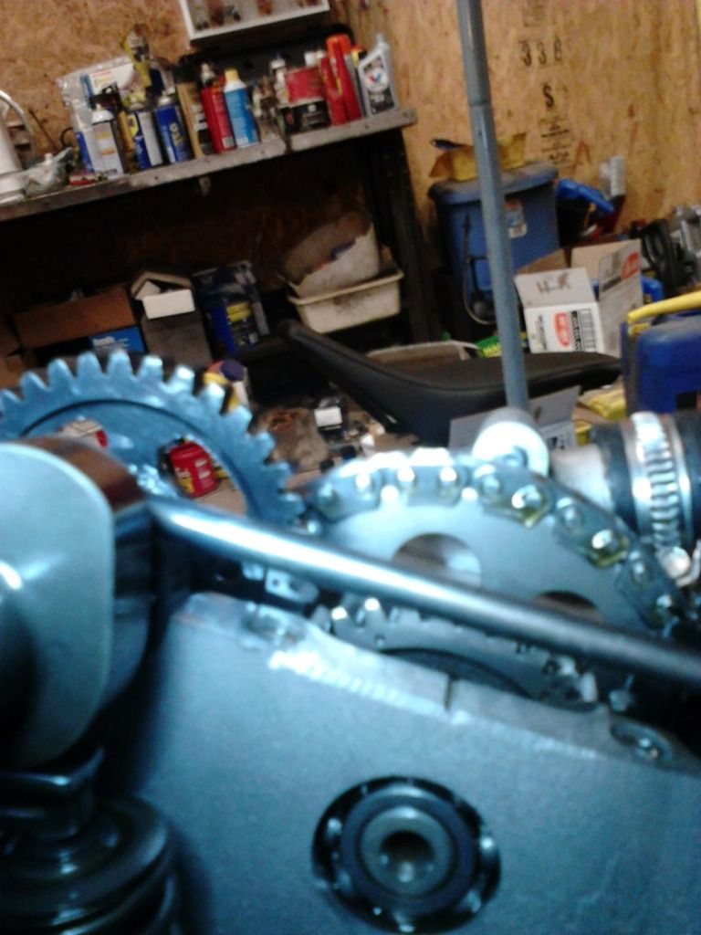

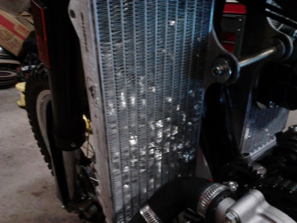

Pulled the valve cover and plug and found TDC here's the 1st 2 problems I saw!

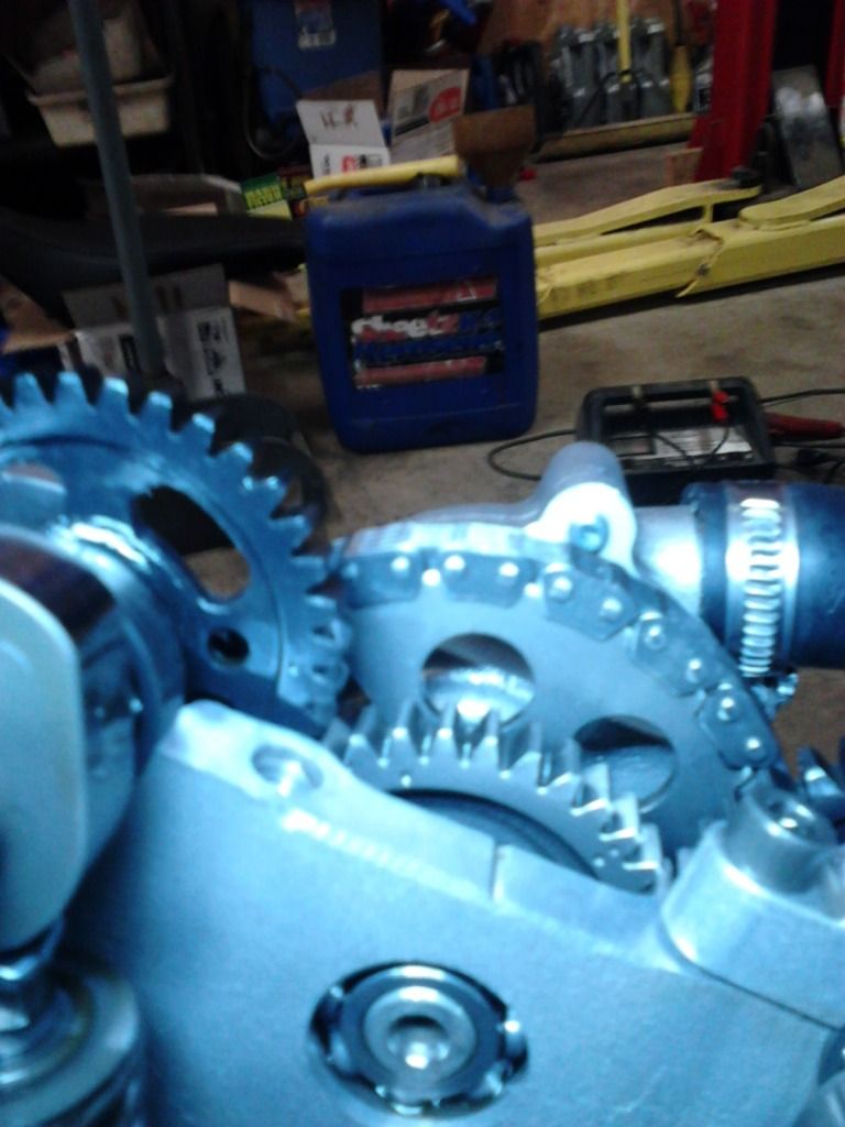

Then looked from the other side and saw problem #3

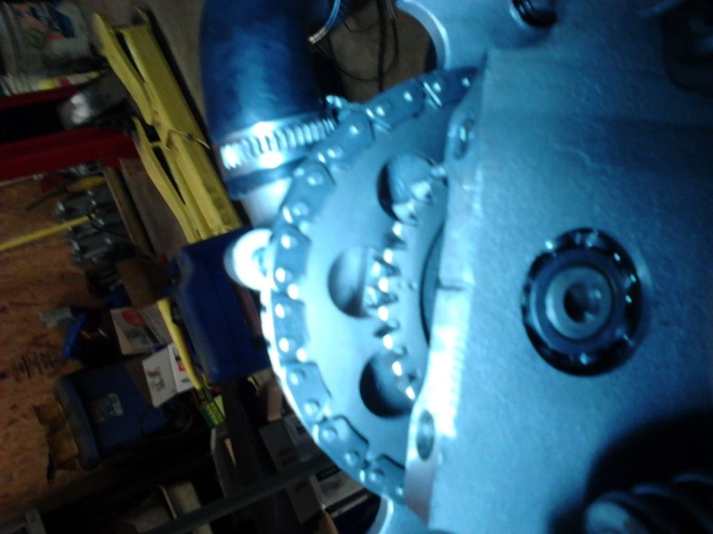

Then checked cam alignment.

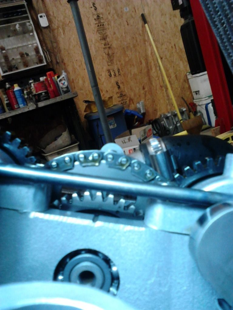

Putting it back together:
Hit the starter and it fired in 3 turns and sounds much better. I thought it ran good before, should really run now that it's in time. Had to slow the idle down and raise the CO settings. Can't wait till the rain stops to try her out.
So much for the expert Husky mechanic. I'm going to call him tomorrow and give him hell! for banged up radiator and 3 teeth out of time. I had to redo his screw up and I didn't even get warranty reimbursement.
