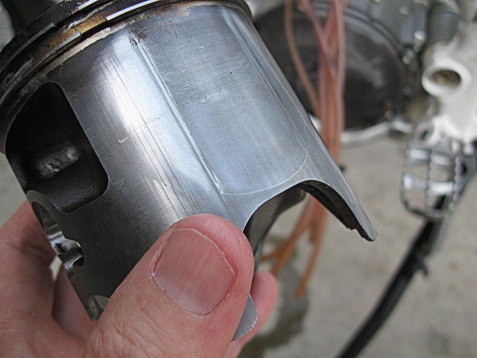

Not sure how many hours you can get on a top end, but I do know that when you see the little "death smile" on the intake side of the piston skirt, it's time to replace your piston before the skirt breaks right there.
