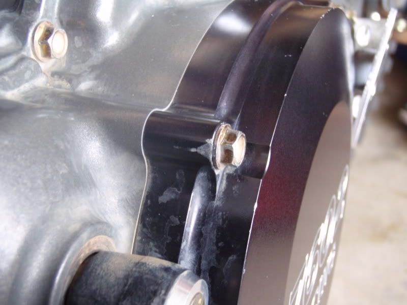

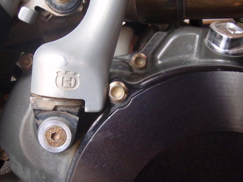

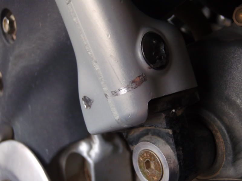

My kickstarter is rubbing on the clutch cover. Its getting to the point where it is starting to wear into the cover. :banghead: How do I fix this?? Or should I even worry about it? Any help is greatly appreciated
Only way to prevent any wearing is to prevent them from touching each other. But where it is wearing on the cover will not affect anything other than the looks.
Thanks !
Is there anyway to adjust the kickstarter position?
The cover's holding up great and I don't want to narf it up, well not that way at least :thumbsup:
Thanks !
Don't know, never had reason to take mine off.
Let it narf it up, it's beefcake, it can take it.
Pull your kick starter off and rotate forward one tooth. I think yours is to far forward, mine is far from hitting.
I have never had the kickstarter off. Could this just be a set up thing from the dealer? :excuseme:
Is it just the one allen to remove it?
Could easily been wrong from the factory, people make mistakes.
I can understand that. I make them often.
I will pull it off and move it back a tooth tomorrow.
Thanks for your help!:cheers:
