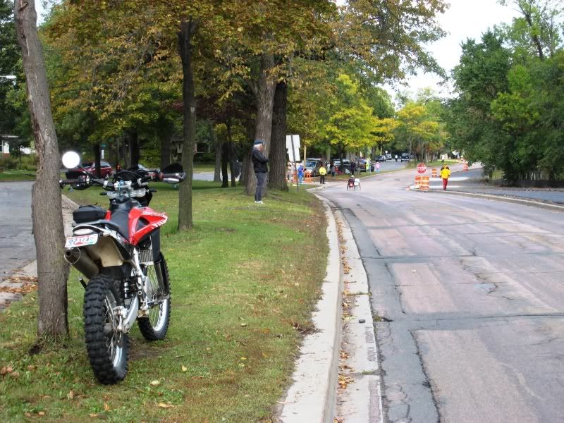

I set mine up for road work using a T15 front and a T44 rear to get some top-end speed. I also changed the tires over to K270s front and rear and now I'm good to go in the rain as well. This bike is going to get me speeding tickets as it is impossible not to run through those gears. Love the power ban on Husky's, great bike and I own enough sprockets to set it up for any kind of riding I might like.
Here is the issue for me, with the road use I find that anything but smooth roads/highways causes my chain to whip so much that I have to tighten it up more then is recommended, this is so that the chain doesn't hit the frame and grind out the metal. This means that the jerkiness of the highway ride isn't cushioned the way a street bike would be. We'll see what this means to the wear and tear on the components, chain, sprockets etc. Around the city I'm constantly changing gears and the ride is perfect, not so on the highways. GL
