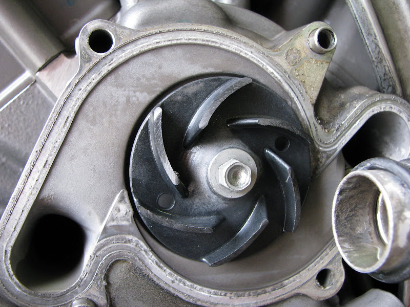

    dude get back to the water pump. my impellar sheared in mexico on an ugly trail ride, stream water kept me going to the finish, I was ready for pee if I had to. I rode a couple times after that still not knowing the root of the heat issue, finally a couple weeks later I did a sanity check and pulled the cover off the pump and found my impellar missing blades the nut and the center stripped with the impellar shaft spinning inside it. installed the new impeller and all has been good. Its another good quick trouble shooting thing to do on the list. R

    I looked at the impeller the other day and it looks fine. Even cycled the kick starter a few times to make sure it was spinning w/ the engine.
    All was fine.
    Thanks for the suggestion.
    PS how do you know if you have the High Flow pump or not. I thought the 2010 models all came with it stock, but am not sure.
    The actual impeller looks pretty weak from a hydrodynamic point of view. The Impeller blades are square and flat, not like the nicely curved ones of my KTM 950.
    KTM impeller:
    vs.
    The Husky POS on the left:
