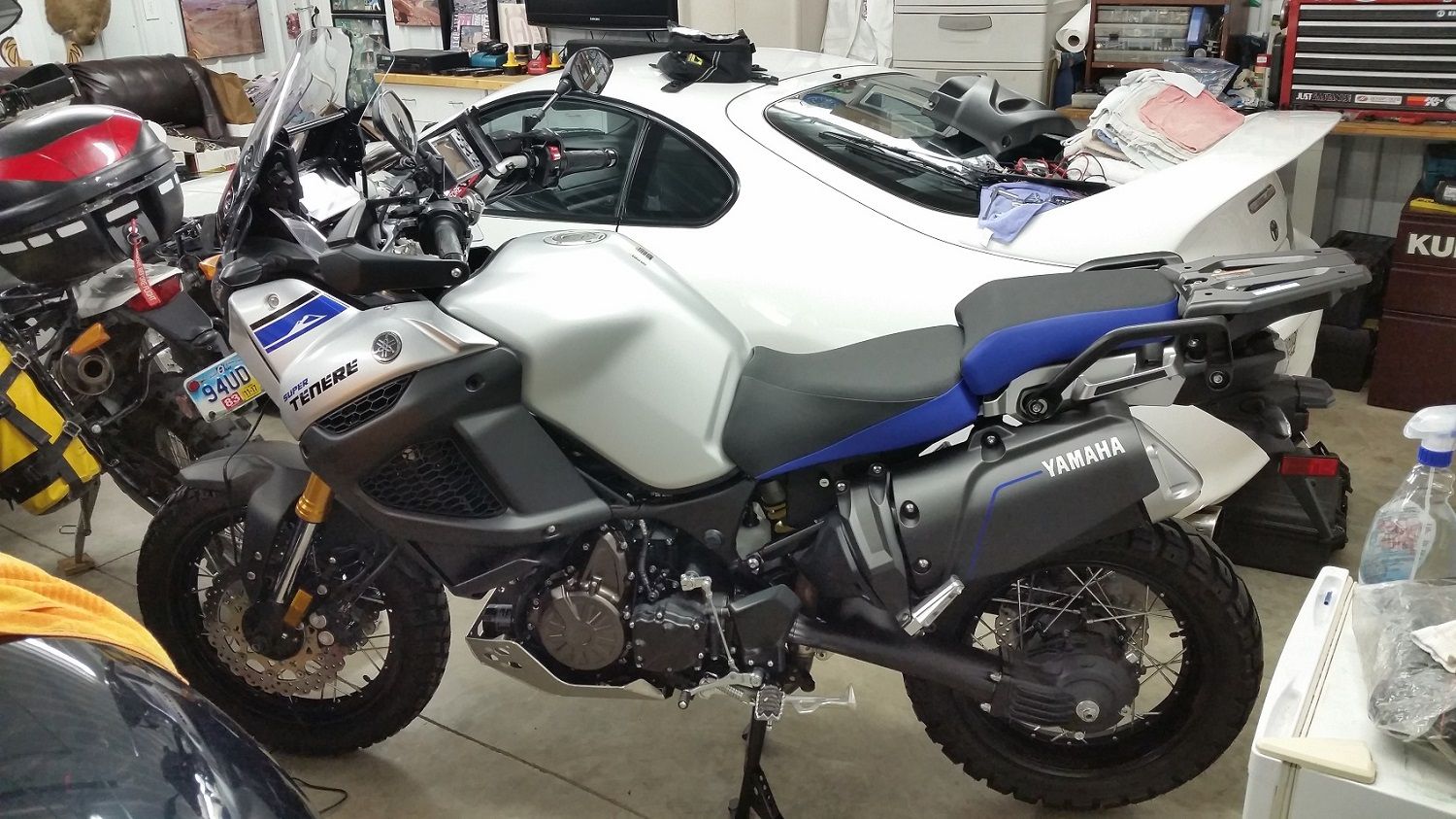

Found this '15 Super Ten w/ 1300 mi for $8800 last week, it will be interesting to see how it overlaps w/ the 630... a 501s will have to wait a while.

It's the little quirks that cause me doubts as well, and like Erik I've never fully trusted it, although perhaps unfairly because it's ever let me down.
