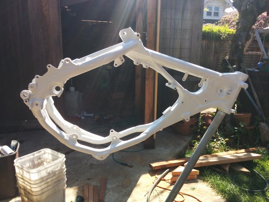

  16. dhallilama Husqvarna
    '96 WXC 250
    many. i'm addicted.
    put a steering stop on the stem (adjustable)
    filled/drilled the wallowed out peg holes
    motor mounts done
    gave it a quick sanding, degrease/dewax
    coat of white appliance epoxy...
