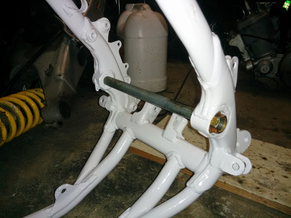

    a replacement for the Grade 5 hardware store swingarm bolt... an actual metric Husky part:
    side note: seems that damn near every husky from 1993 through 2014 used the same bolt.

    and a lot of things were implemented in 95, that lasted a while. bike sure looks alot better with that swinger pivot and white paint!

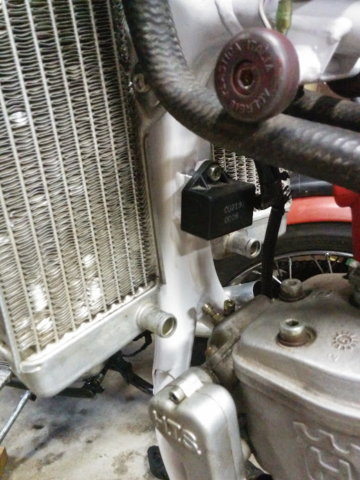

    oh, yay... the clutch cable mount is broken on the case... sure, why not. :D
    i'm debating either weld it, with the cases together as is...
    or cut the rest off, machine a stop and drill/tap the case...
    leaning towards the later
  13. juicypips Husqvarna
    gloucestershire
    wr 360. 2002
    Crap, take it apart get it welded re drill the hole, or leave it and put a bit of retaining wire on a washer too nearest bolt to hold it in position.
    Looks like it will still work, but its not right.

    i'm a welder, so that part isn't difficult...
    but it just occurred to me that i may be over thinking the whole thing: old Yamahas just have a metal bracket that bolts onto the jug. i'm gonna make a bracket to drop off of the jug bolt in that photo. easy peasy...

    yeah, you see that from time to time. i think part of it is the jammig the cable does against the coolant hose as well. a crappy setup right in that area...

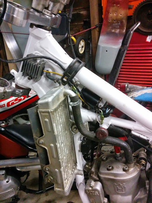

    getting closer...
    my local hardware store is an awesome resource for metric fasteners... 12mm 10.9 in damn perfect shoulder/thread length for the linkage. picked up a bunch of 6, 8, 10 & 12mm in 10.9 and stainless to replace most of what was on the bike.
    radiators have had some abuse, but both pressure test just fine so i'll run 'em.

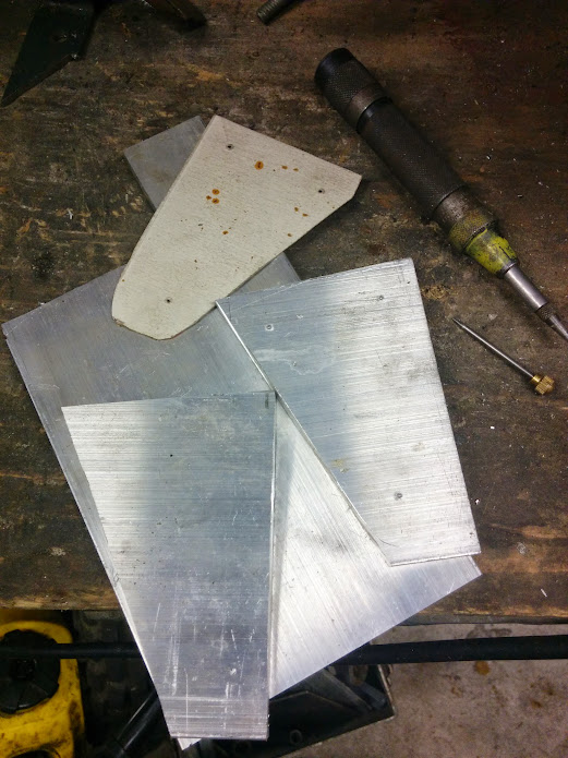

    damn head steady that came on the bike was some crap 1/8" x 1" steel that likely did nothing...
    used one on ebay for $20...
    or rummage through the scrap pile for some T6 aluminum...
    template out of cardboard, transfer to material (dammit, out of dyechem) and cut the aluminum:

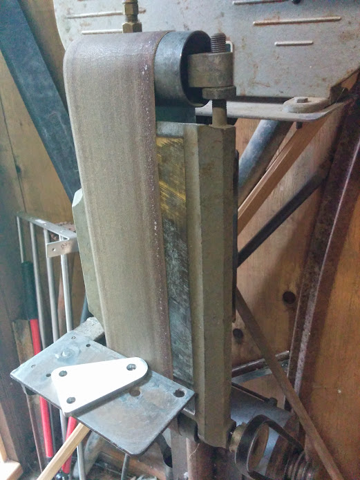

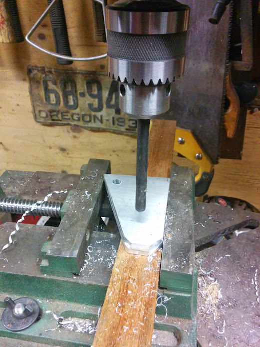

    transfer punches come in handy for lots of things... transferring the hole locations from the frame/head... centering the drill...
    hit the edges, radius the corners on the sander...
    boom. new head steady...
    not bad for 22 minutes, start to finish. half of that was spent trying to figure out where i put my coffee.
