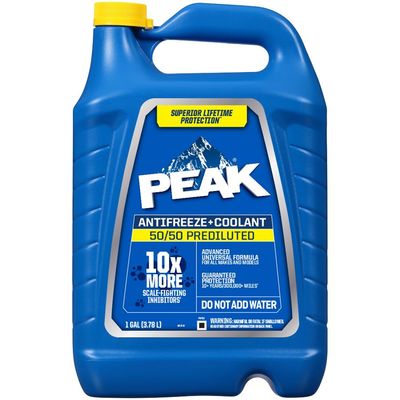

    [IMG] [IMG]
    Features & Benefits
    Its inhibitors provide maximum cooling system protection against damaging rust and corrosion. Convenient prediluted antifreeze -No need to add water. Amber color will not change the current antifreeze color when used for topping off. Features a phosphate-free and silicate-free formula.
    Glengemen likes this.
