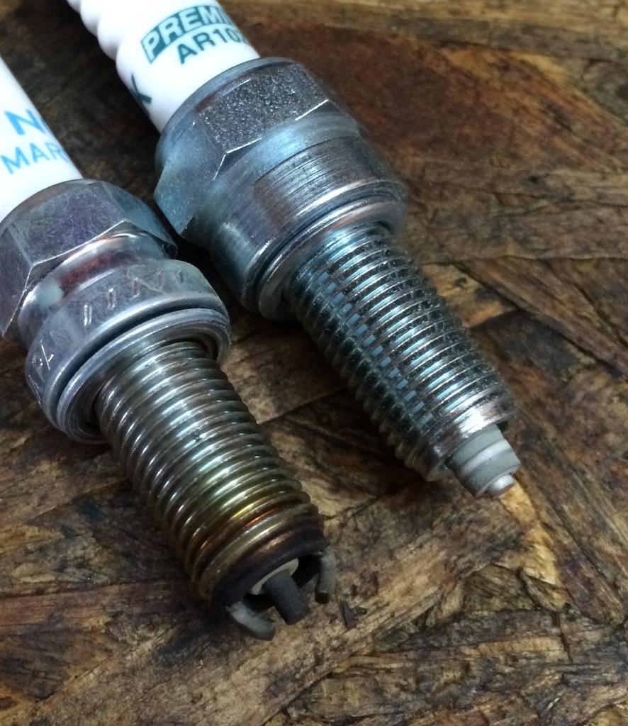

  5. hasenpfeffer Husqvarna
    CO
    Had a chance to put in the AR10ZS plugs. Me likey!
    I only took it around the block, so I don't have much time. But, I don't hear any decel popping, and I didn't feel any stumbling from take offs. Both occurred previously.
    Of note, I have a completely stock bike as far as air and fueling go.
    Geeza likes this.

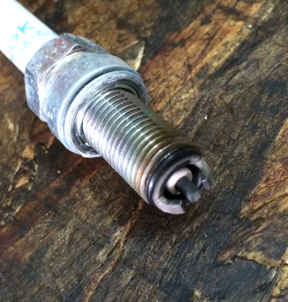

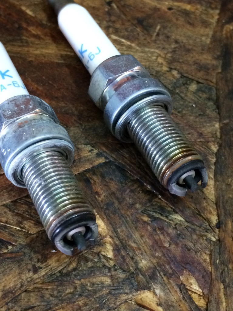

  6. hasenpfeffer Husqvarna
    CO
    Here's my original plugs. 5225 miles. Inside plug pictured first. Note that the lighting makes the inside plug look whiter. They actually look pretty close to identical in person.
    Edit:
    Here's a more representative pic. Inside on left.
    PaulC likes this.
