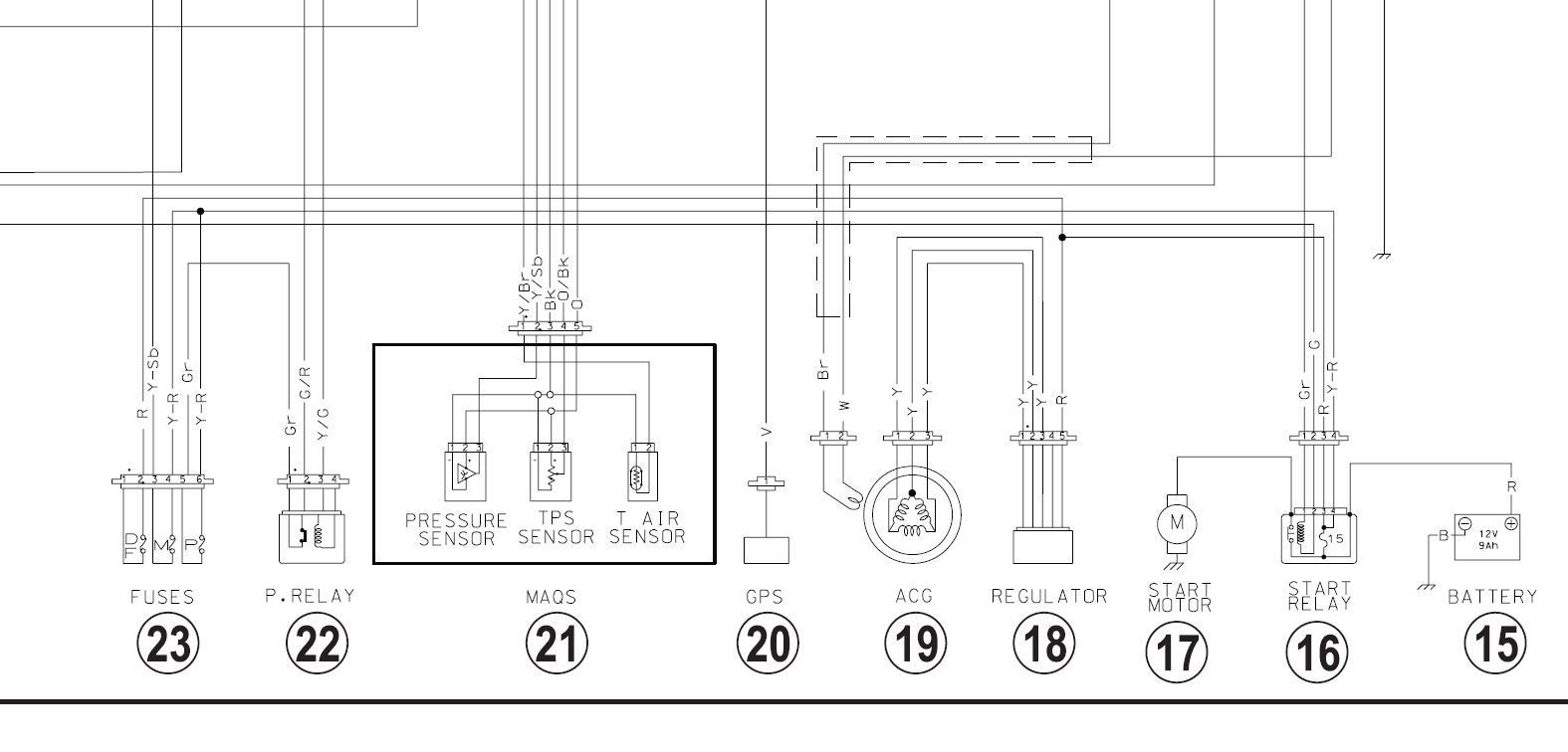

  20. DYNOBOB Husqvarna
    I'm sure you've already double checked the fuses and all ground connections. It looks like the red wire connects to something thru fuse "DF". That red wire also goes over to the start relay and then to the battery. If the red wire shorted to ground at the regulator there could have been huge current flow from the battery thru the start relay and it could be damaged. Since all power to the bike appears to flow thru the start relay that's what I'd be looking at. EDIT: Actually, that's a 15a fuse in the start relay so a short at the regulator should just pop that fuse...
    Seems like I recall some problems with the harness/ignition switch area? Either way you may want to get a working reg in there before you chase your tail too much.
