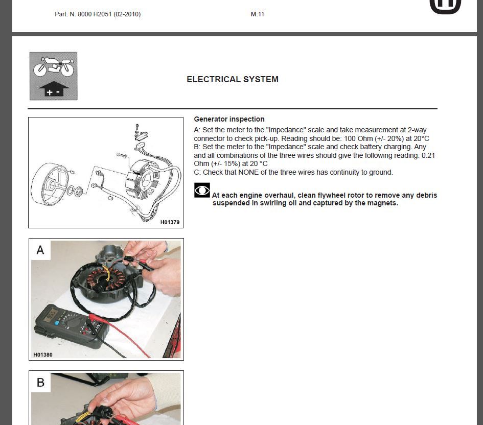

    So the voltage across the three stator wires is consistent at 24VAC at idle, 40 VAc at 3000 rpm and about 68 VAC at 5000 RPM. Consistent, but does seem a bit high. I have no frame of reference but I would have expected about 12VAC at idle (+/-). It does somewhat explain the High Voltage warning light on the Striker dash computer. Resistance across the coils is 0 Ohms (continuity) and there is no short to ground. Again, resistance seems a bit low, as most of what I've read indicates a few ohms of resistance is normal (2-3 Ohms seems common).

  5. DYNOBOB Husqvarna
    Have you checked stator per manual?

  6. KayDubbya Husqvarna
    B.C.
    2011 TE630
    BMW F650GS
    Yes. I've checked it and the resistance is coming up as 0 Ohms, but I'm guessing my bargain basement multimeter is off a bit. .21 Ohms is as close to zero as this thing is likely to measure and short of getting a $1000 Fluke meter I'm going to assume I'm good on impedance. There's no continuity to ground (as it should be) and the AC voltage checks out while it's running. I will double check the pick-up resistance, but I'm moving away from the stator as the problem. I'm getting the same high voltage warning from my Trail Tech Striker unit even when the stator is completely disconnected (running off the battery alone) so I'm going to see if shielding the coil is of any use. Thanks all the same. My OCD gets out of hand sometimes but I really want to get this sorted. I've fried 4 USB plugs already and it's pissing me off no end.
